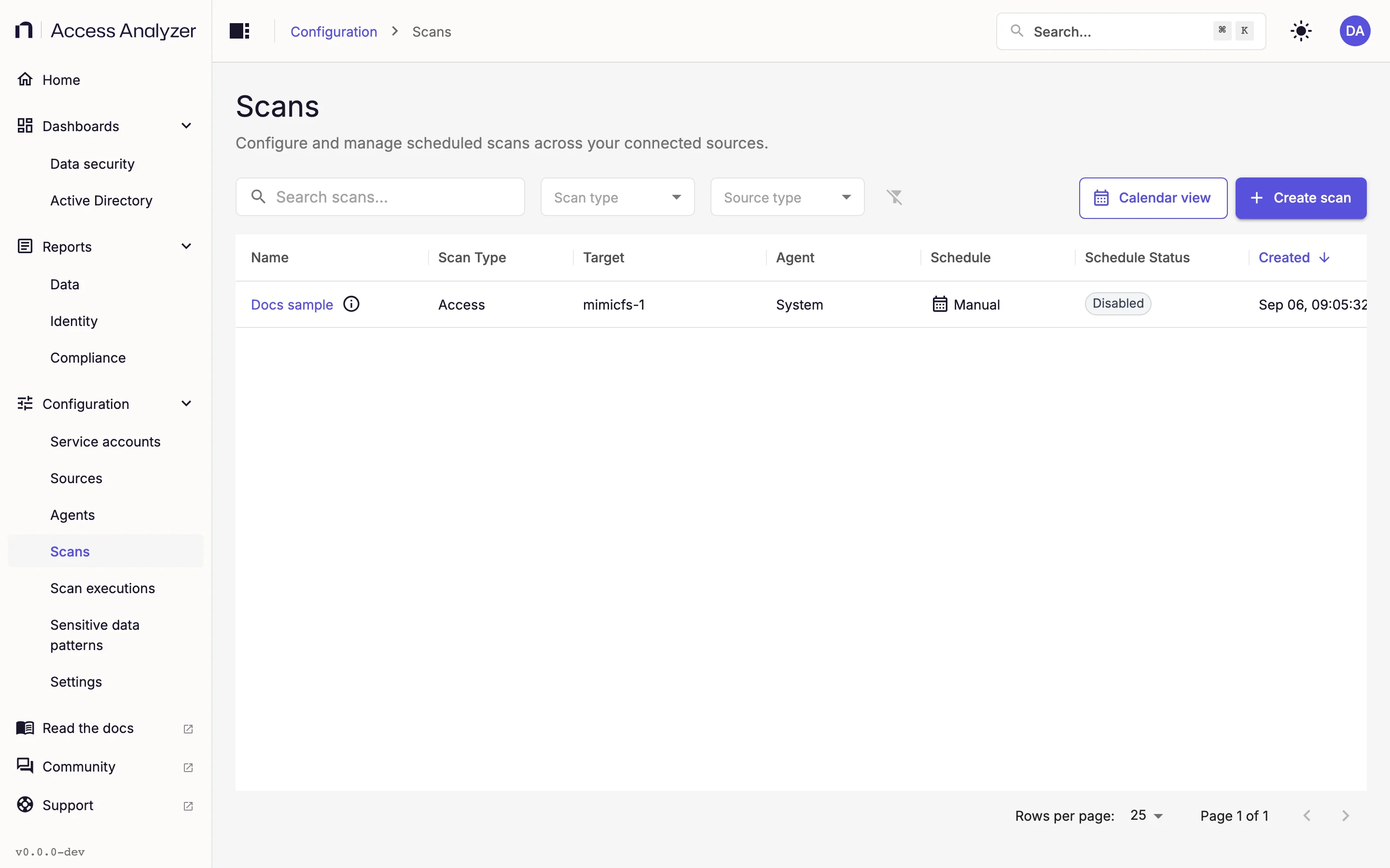

The Scans Page
Go to Configuration > Scans. The page lists every scan with its type, target, agent, and schedule.
Scans list showing one configured scan with its type, target, agent, schedule, and created columns
ColumnWhat it shows
NameThe scan's name. Click it to open Edit scan. An icon next to the name shows the scan's description in a tooltip.
Scan TypeAccess, Sensitive data, or Identity sync.
TargetThe sources the scan covers, or the labels that select them.
AgentSystem when the scan runs on the System agent, otherwise the agent label as key=value.
ScheduleManual, or a short summary of the schedule such as Daily 2AM or Hourly. Click it to open the calendar.
Schedule StatusActive when the scan runs on a schedule, Disabled when it runs manually.
CreatedWhen you created the scan.
ActionsThe row menu; see Row actions.
Search scans… matches the scan name, the scan type, the names and types of the target sources, and label selectors written as key=value. The Scan type and Source type dropdowns narrow the list further, and Clear filters resets both. You can sort by Name, Scan Type, or Created; the newest scans come first by default. The table shows 10, 25, 50, or 100 rows per page.
Scan names don't have to be unique. Two scans can both be called "Finance shares", so give scans names that tell them apart at a glance.

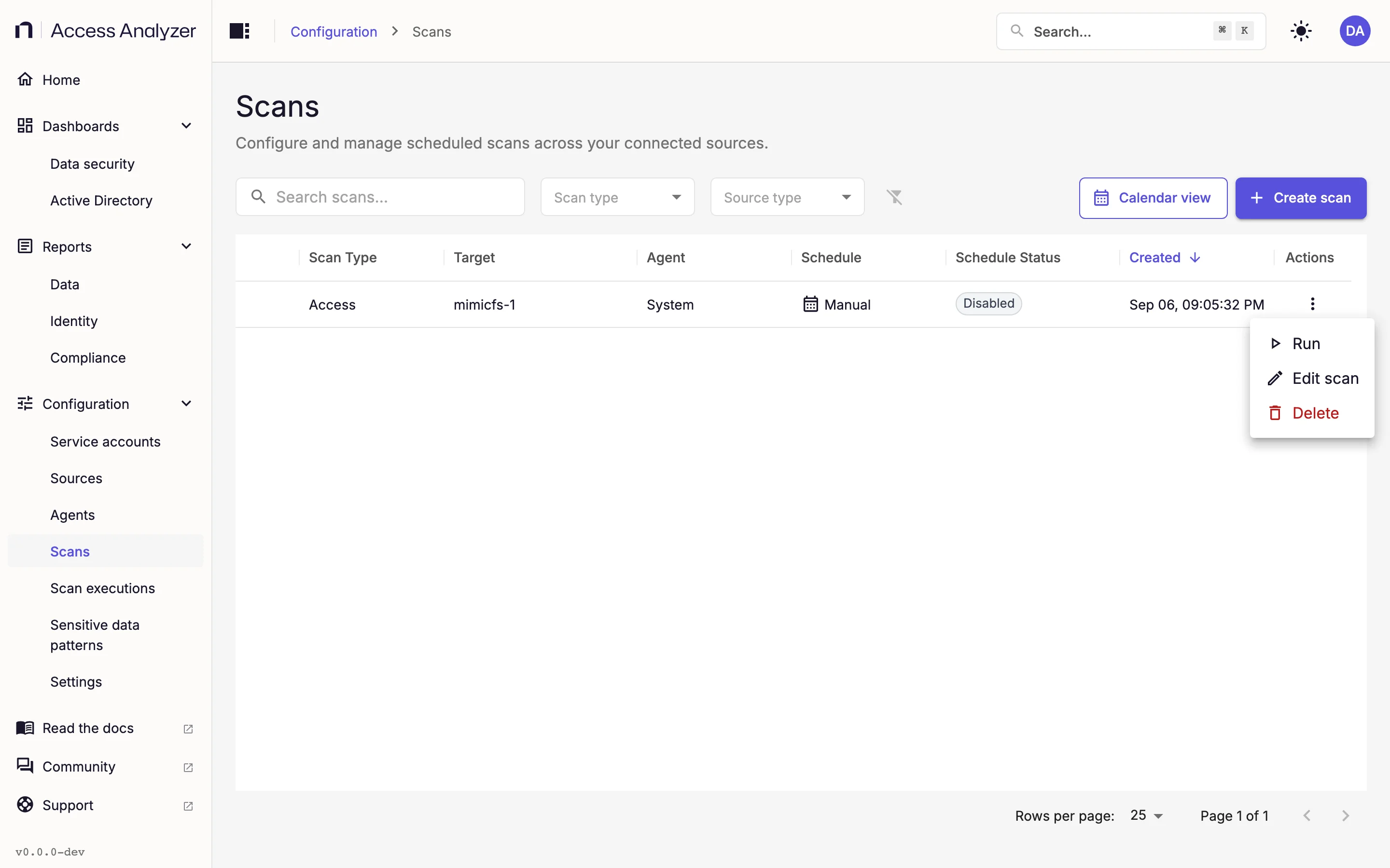

Row Actions
The Actions menu on each row offers up to five items. Run, Pause, and Stop appear only when they can do something.
Scan row actions menu with Run, Edit scan, and Delete
ActionWhat it doesWhen it appears
RunStarts one execution per target source, or resumes a source's paused execution, and opens Scan executions filtered to this scan.At least one target source has no execution in progress, or has a paused execution you can resume
PauseAsks every active execution of the scan to pause. Paused executions keep their progress, and you can resume them.The scan has an execution that can be paused
StopOpens Stop scan, which stops every running and paused execution of the scan.The scan has an execution that hasn't finished
Edit scanOpens the scan at the Review step.Always
DeleteOpens Delete scan.Always
After Run, a notification reports the outcome: Scan started with the number of sources started, Scan resumed when the run picks up paused executions, Scan already running when every source already has an execution in progress, or Scan partially started when some sources couldn't start. If a scan targets sources by label and no source carries those labels at the moment, there is nothing to run and the scan doesn't start.

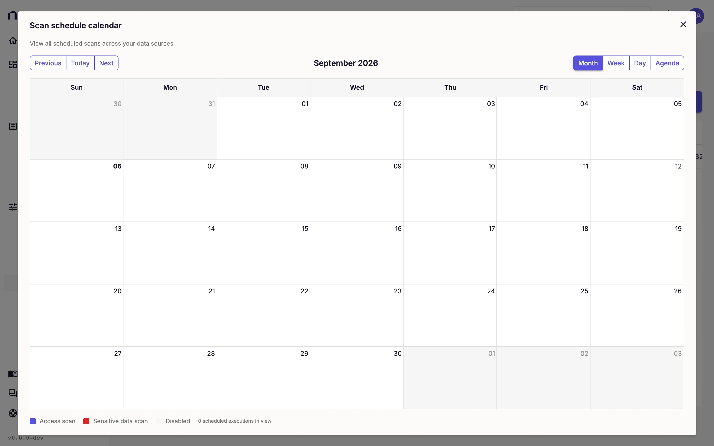

Calendar View
Calendar view opens the Scan schedule calendar, a month grid of upcoming scheduled runs across every scan. Switch between month, week, day, and agenda views, and move with Previous, Today, and Next. The legend tells Access scan, Sensitive data scan, and Disabled entries apart, and the footer counts the scheduled executions in view. Clicking a scan's Schedule cell opens the same calendar.

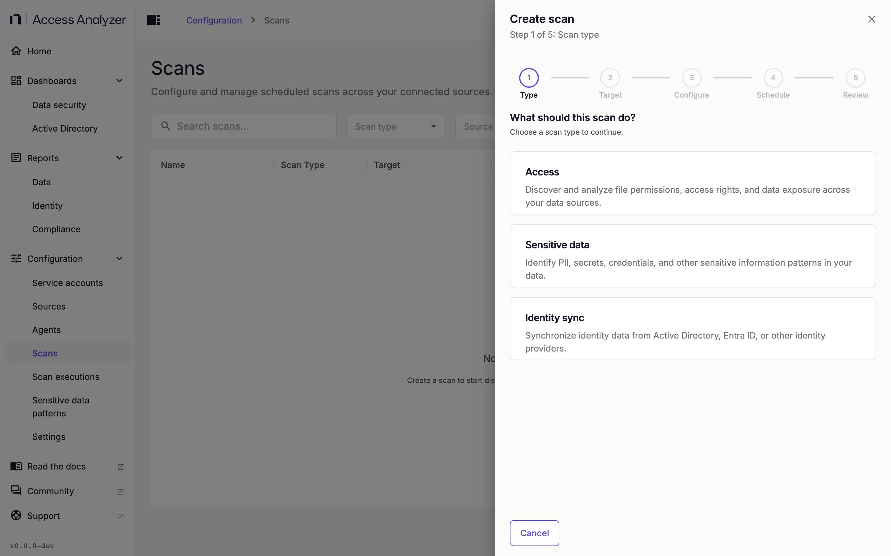

Select the Scan Type
  1. Under What should this scan do?, select Access, Sensitive data, or Identity sync.
  2. Click Next.
Create scan step 1 with Access, Sensitive data, and Identity sync cards
You can't change the scan type after you create the scan. To collect something else, create another scan.

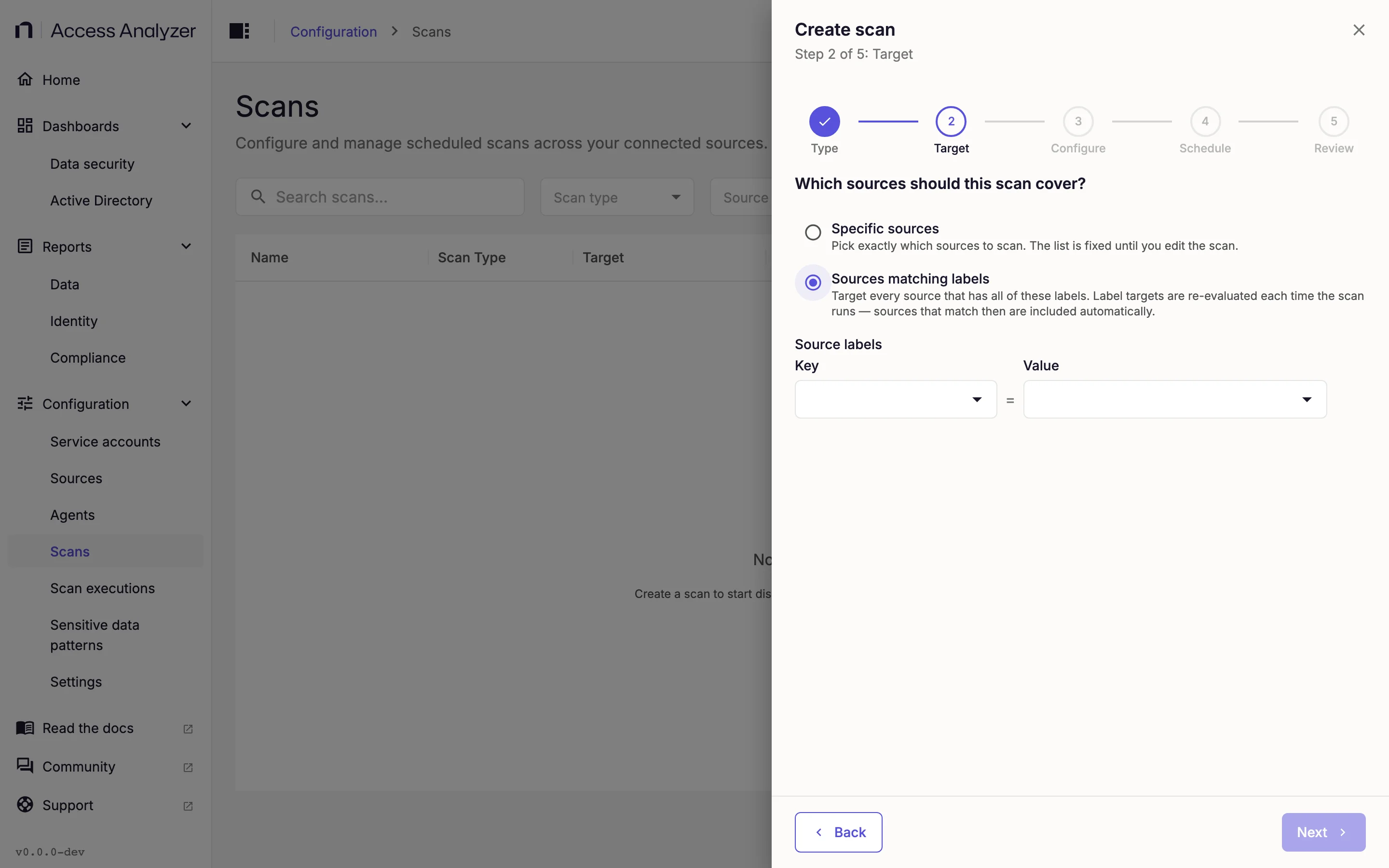

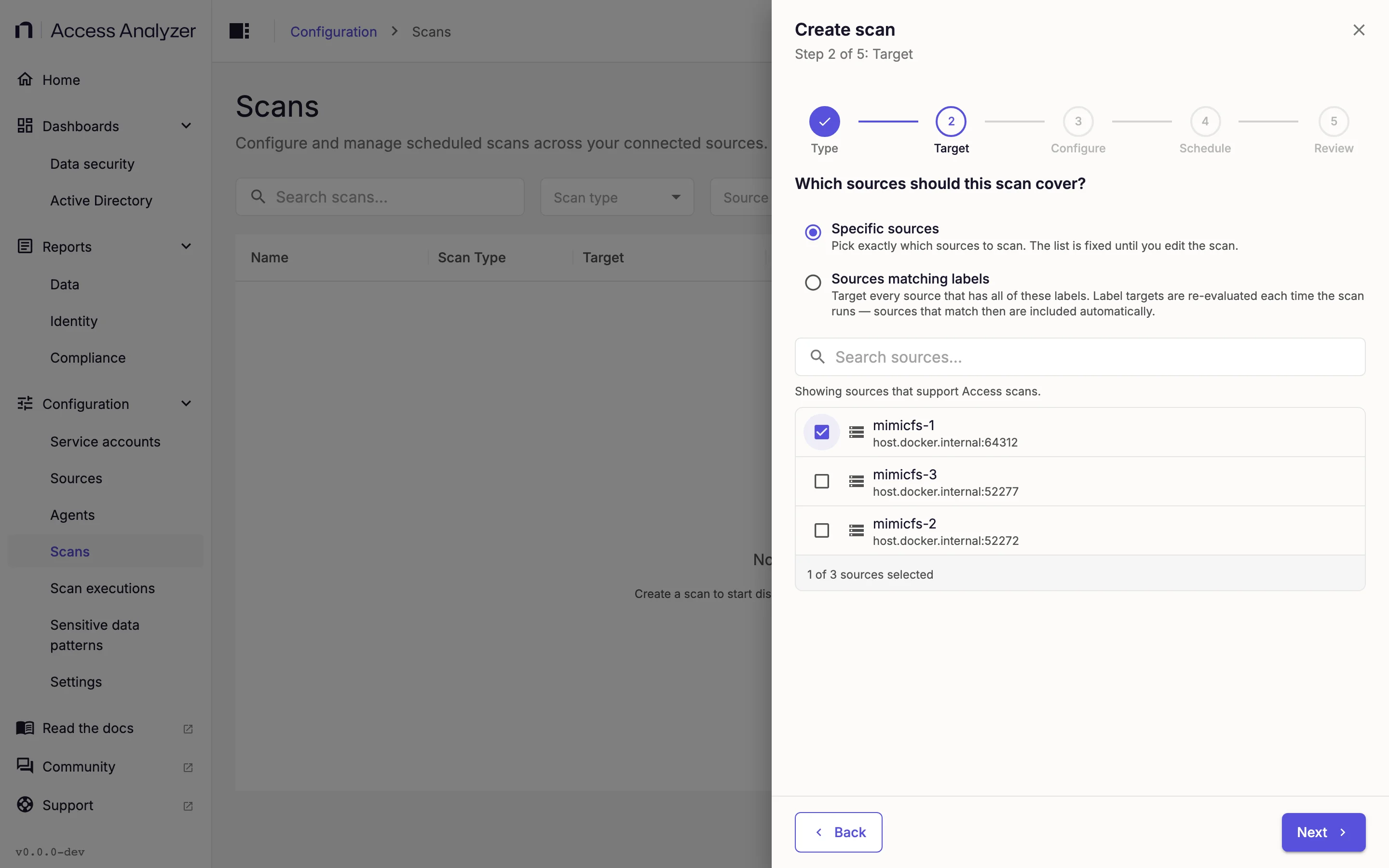

Select the Target
Under Which sources should this scan cover?, select one of two targeting modes.
Specific sources is a fixed list. You pick the sources, and the list stays as it is until you edit the scan. Sources matching labels is a rule: the scan covers every source that carries all the labels you select. Access Analyzer re-evaluates the rule every time the scan runs, so it picks up sources that gain the labels later and drops sources that lose them.
Either way, the step offers only sources whose type supports the scan type. If none do, the step says so, and you need to add a suitable source first.
  1. Select Specific sources.
  2. Select the checkbox next to each source to scan. Use Search sources… to find a source in a long list.
  3. Confirm the counter under the list shows the number you expect.
  4. Click Next.
Create scan step 2 with one source selected
You can save a label-targeted scan that matches no sources yet. It targets whatever matches when it runs. While a scan targets a label, you can't delete that label.

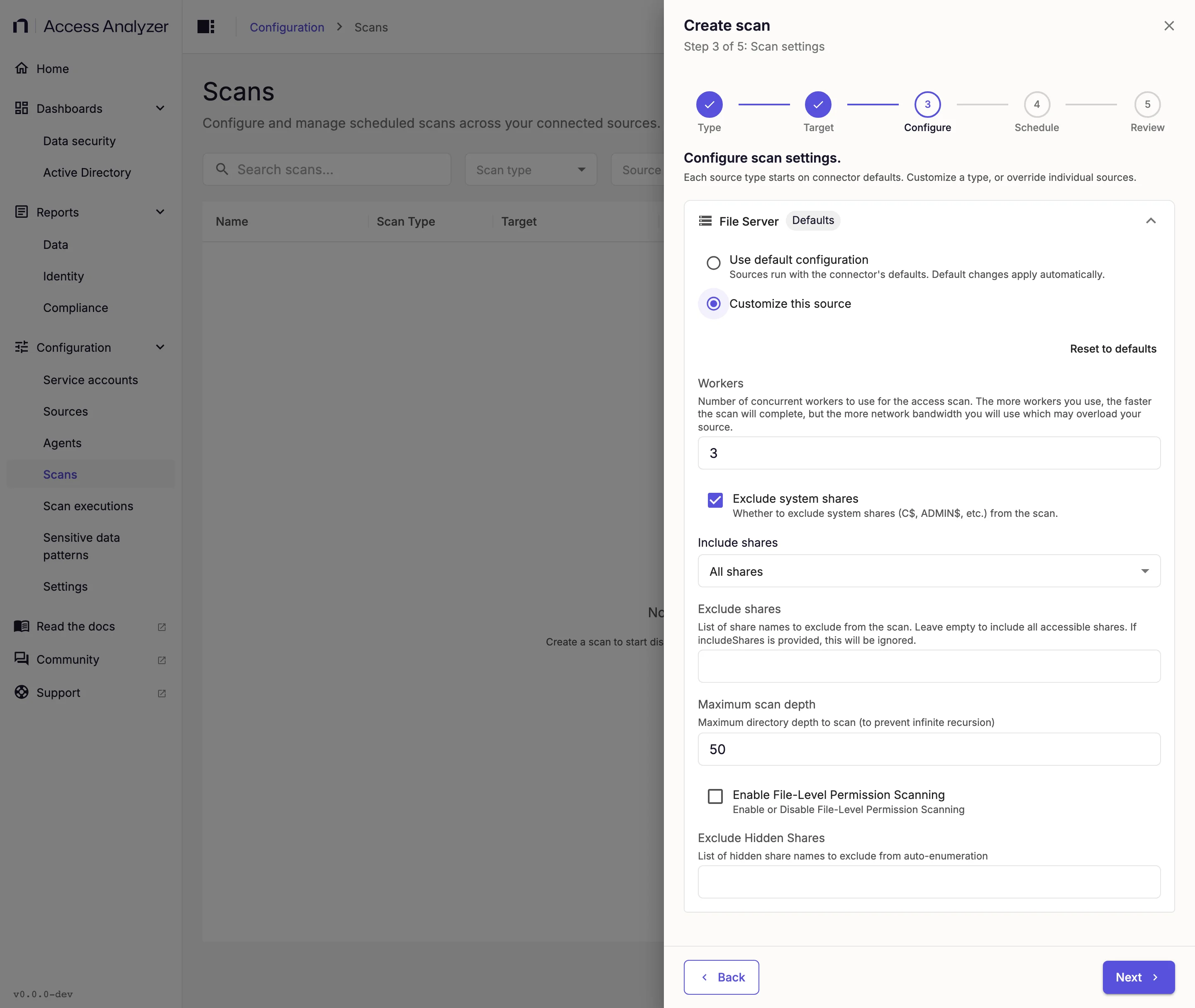

Configure Scan Settings
Every source type in the target starts on its default settings. You can leave it there, customize the settings for all sources of that type, or give individual sources their own values. Scan types lists every setting.
  1. Expand the section for a source type. Its badge reads Defaults or Customized.
  2. Keep Use default configuration, or select Customize for all File Server sources. The label names the source type; when the target is a single source it reads Customize this source.
  3. Change the settings. Reset to defaults puts them back.
  4. To give one source its own settings, under Source overrides, select the source in Source to override.
  5. Click Add source override. The override has its own copy of every setting and its own Agent picker. Remove override discards it.
  6. For a Sensitive data scan, set the pattern groups under Sensitive data classification. See Sensitive data scan.
  7. Click Next.
Create scan step 3 with customized File Server settings
If a source type has no settings for this scan type, the section says so and the sources run with the defaults. For a scan that targets sources by label, individual overrides become available when at least one source matches. If a source stops matching, its override moves to Inactive overrides.

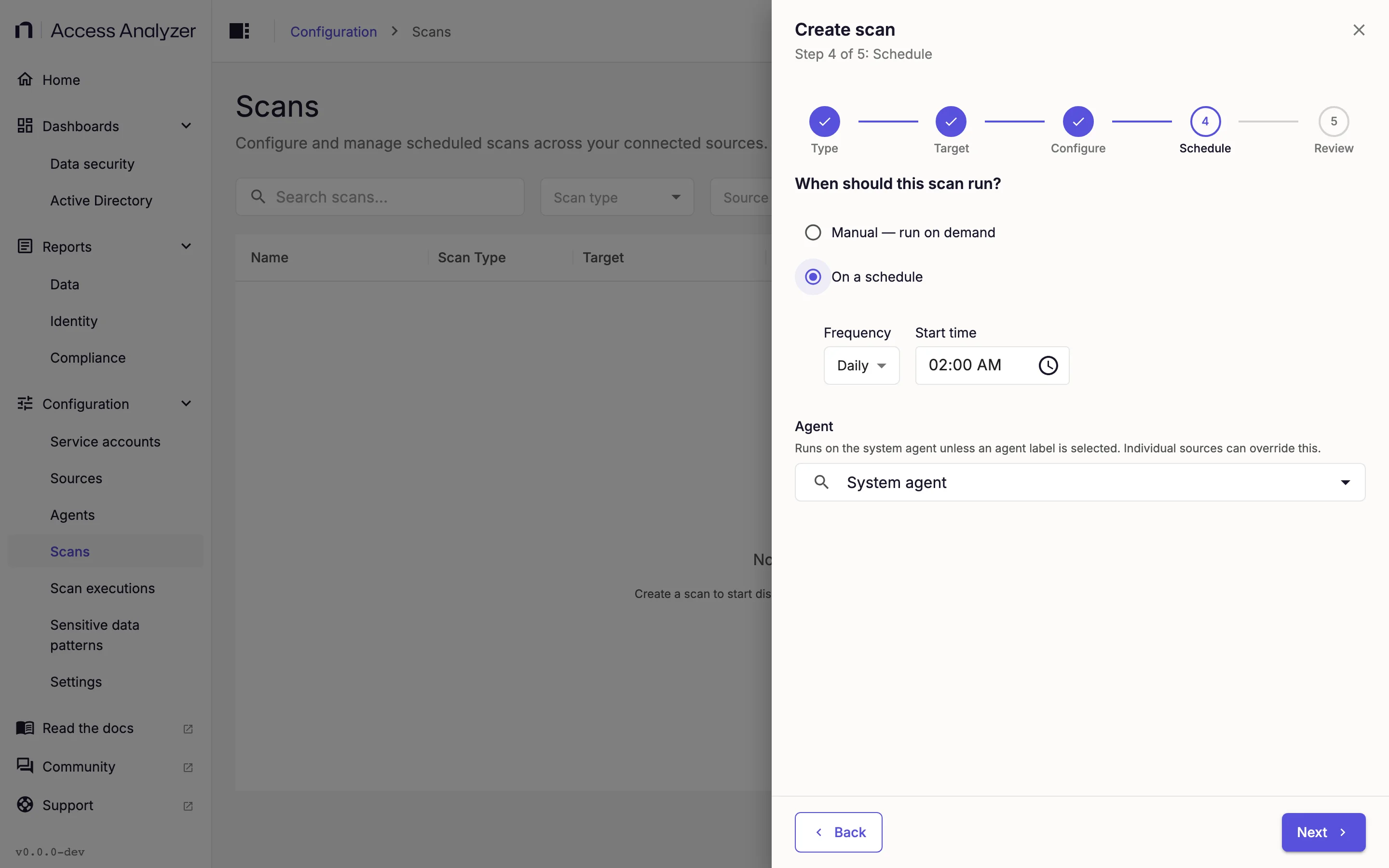

Set the Schedule and Agent
  1. Under When should this scan run?, keep Manual — run on demand or select On a schedule.
  2. If you selected On a schedule, select a Frequency and its time options. Schedules describes each option and the time zone rule.
  3. In Agent, keep System agent or select an agent label. Agent labels and scan routing explains how Access Analyzer applies the choice.
  4. Click Next.
Create scan step 4 with a daily schedule

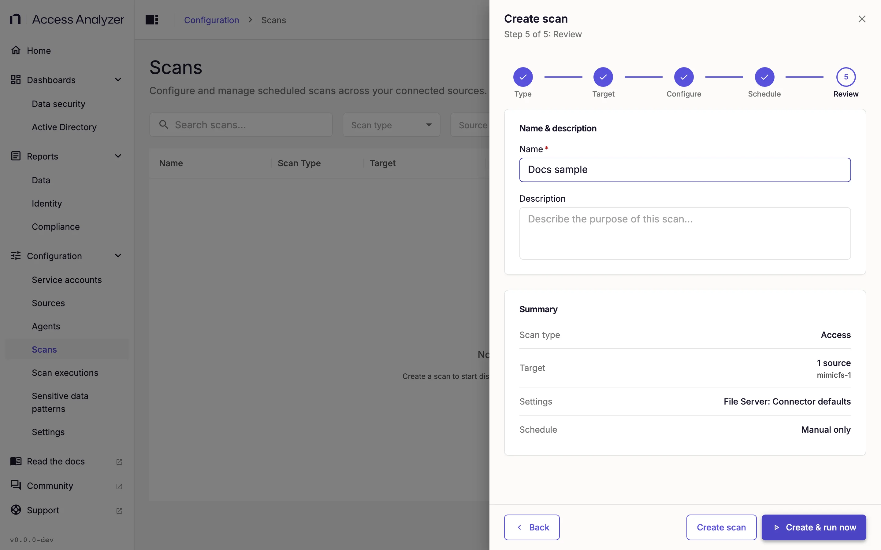

Name and Review the Scan
  1. In Name, enter a name. This is the only required field on the step.
  2. Optionally, enter a Description. It shows as a tooltip on the Scans page.
  3. Check the Summary card. It lists Scan type, Target, Settings, and Schedule. To go back to a step, click Edit next to Target, Settings, or Schedule.
  4. Click Create scan to save the scan, or Create & run now to save it and start it immediately. Both buttons stay disabled until you've entered a name.
Create scan review step ready to create
Create & run now creates the scan first and then starts it. If the run can't start, you see Scan created but failed to start, and the scan is still there to run later from the Scans page.

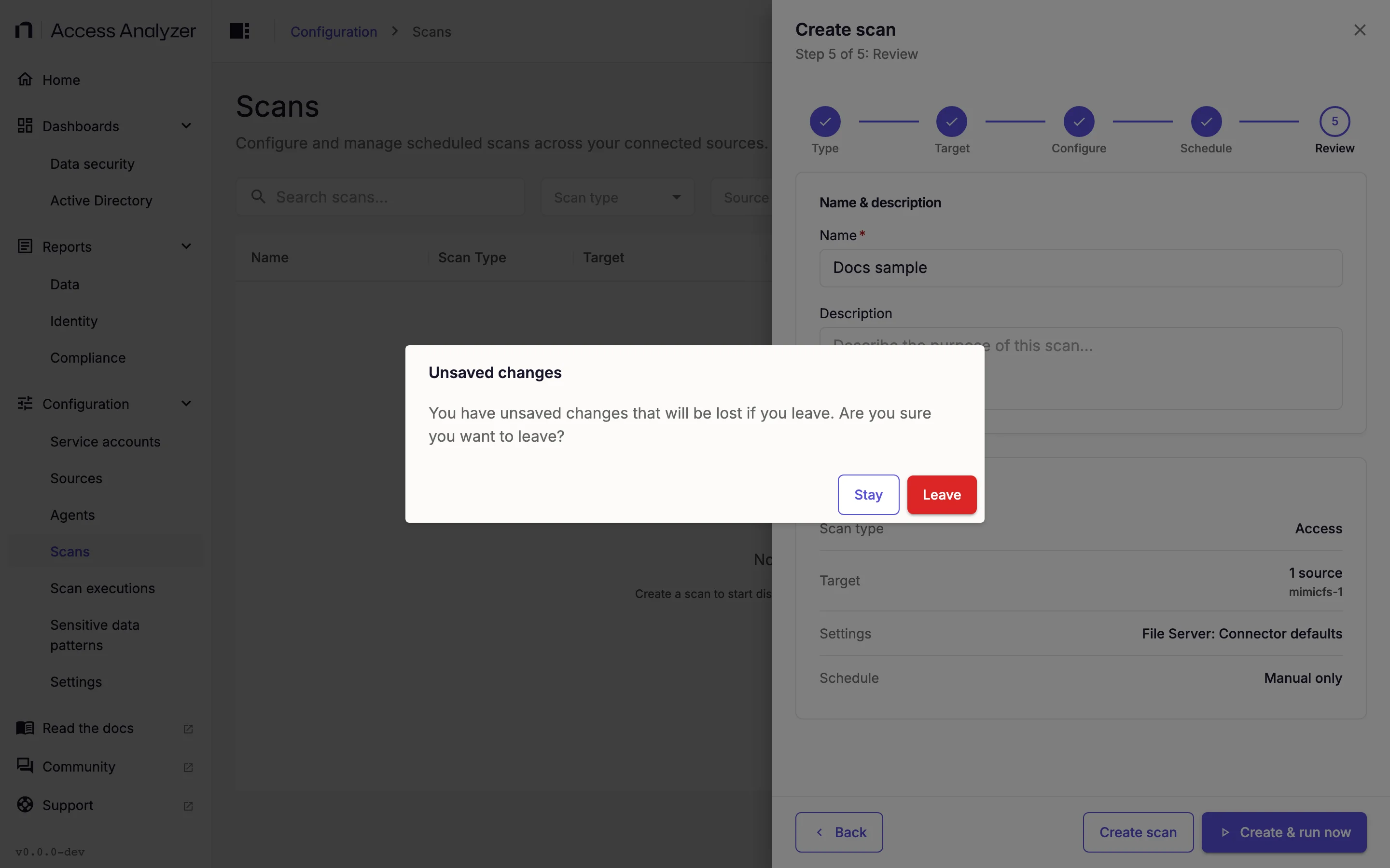

Closing the panel with unsaved changes opens Unsaved changes: "You have unsaved changes that will be lost if you leave. Are you sure you want to leave?" Stay keeps you in the panel; Leave discards the changes.
Unsaved changes dialog with Stay and Leave

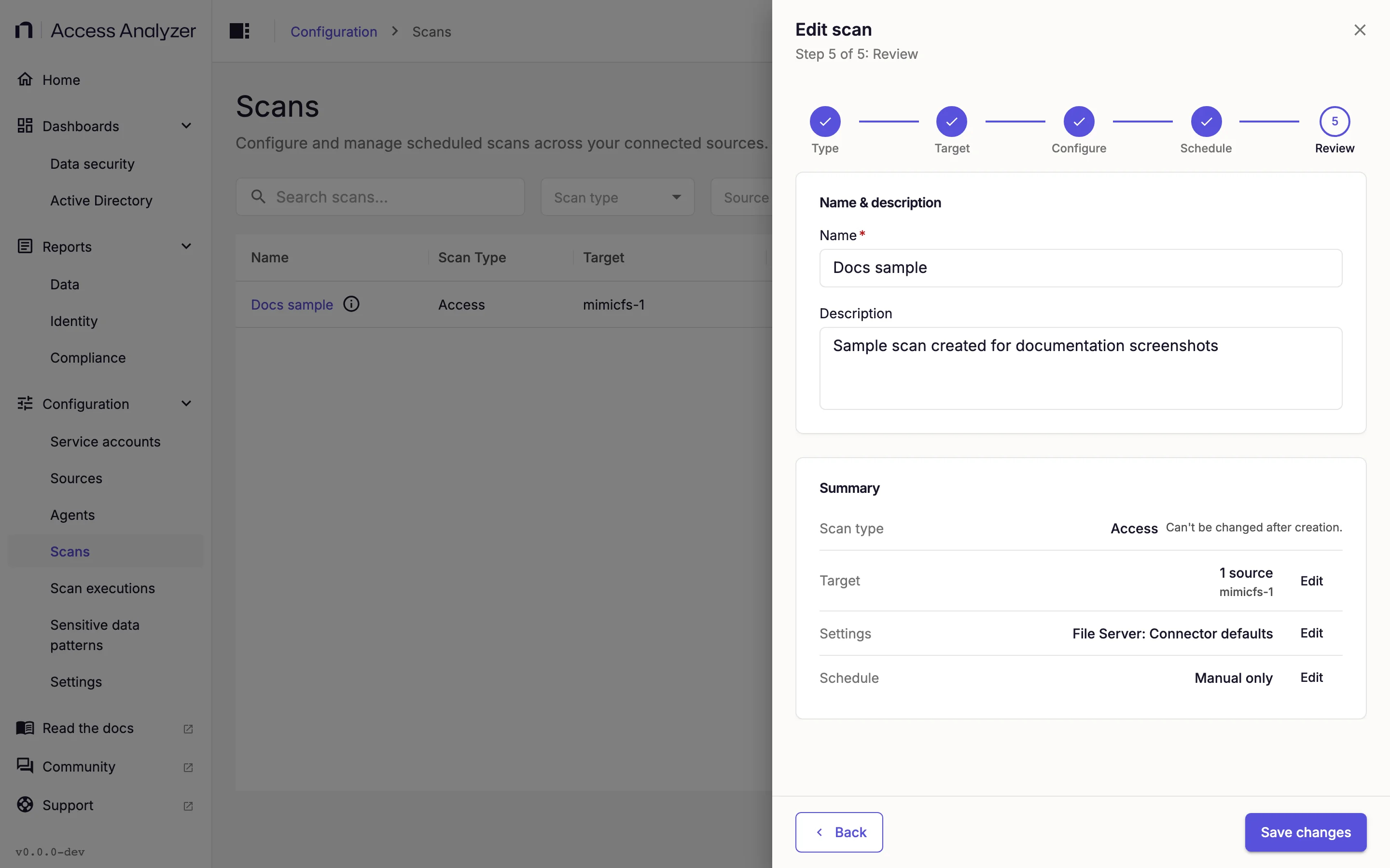

Edit a Scan
  1. Go to Configuration > Scans.
  2. Click the scan's name, or open its Actions menu and click Edit scan. The Edit scan panel opens at Step 5 of 5: Review.
  3. Click Edit next to the section you want to change.
  4. Make the change.
  5. Click Next until you're back at Review.
  6. Click Save changes.
Edit scan panel review step showing name, description, and summary with Edit buttons
Everything except the scan type can change.
Removing a source from a scan's target, whether by clearing its checkbox or by changing the labels so it no longer matches, deletes that source's executions for this scan and stops any that are running.
