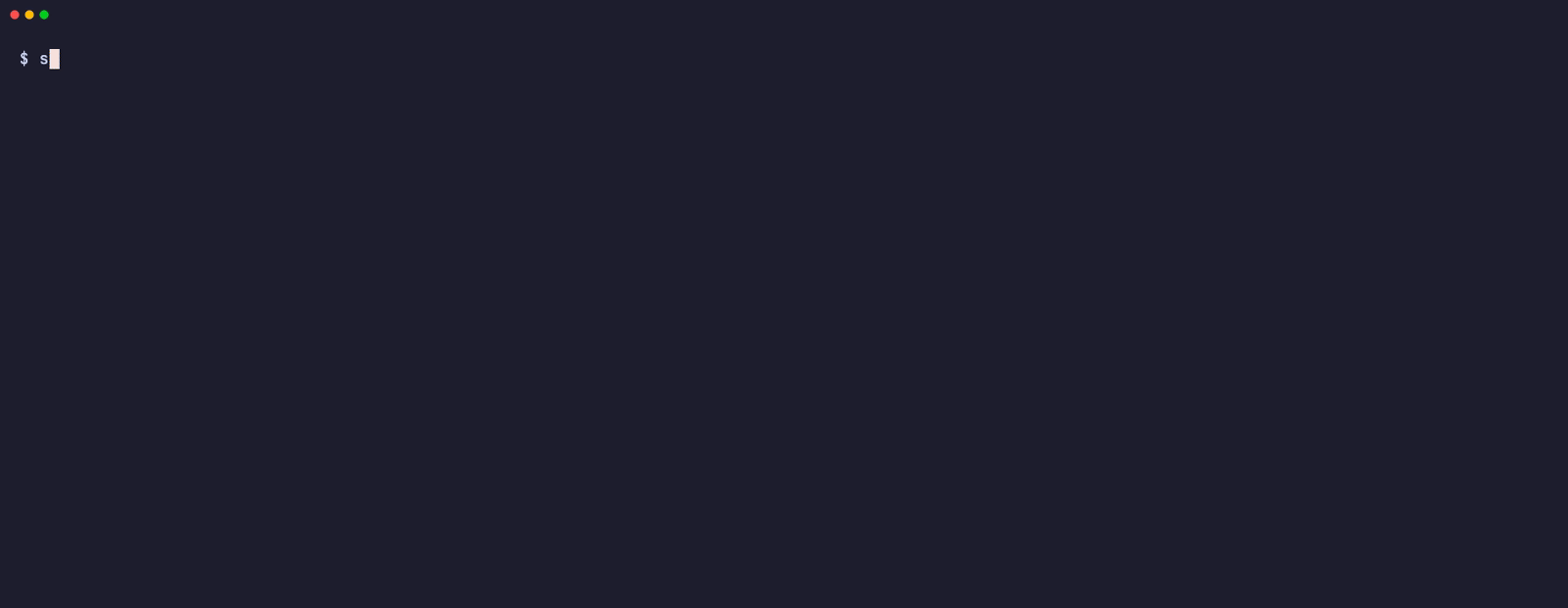

    To confirm, run sudo dspmctl auto-status. Every application should show Yes in all three columns:
    dspmctl auto-status listing every application with auto-sync, self-heal, and auto-prune turned on
