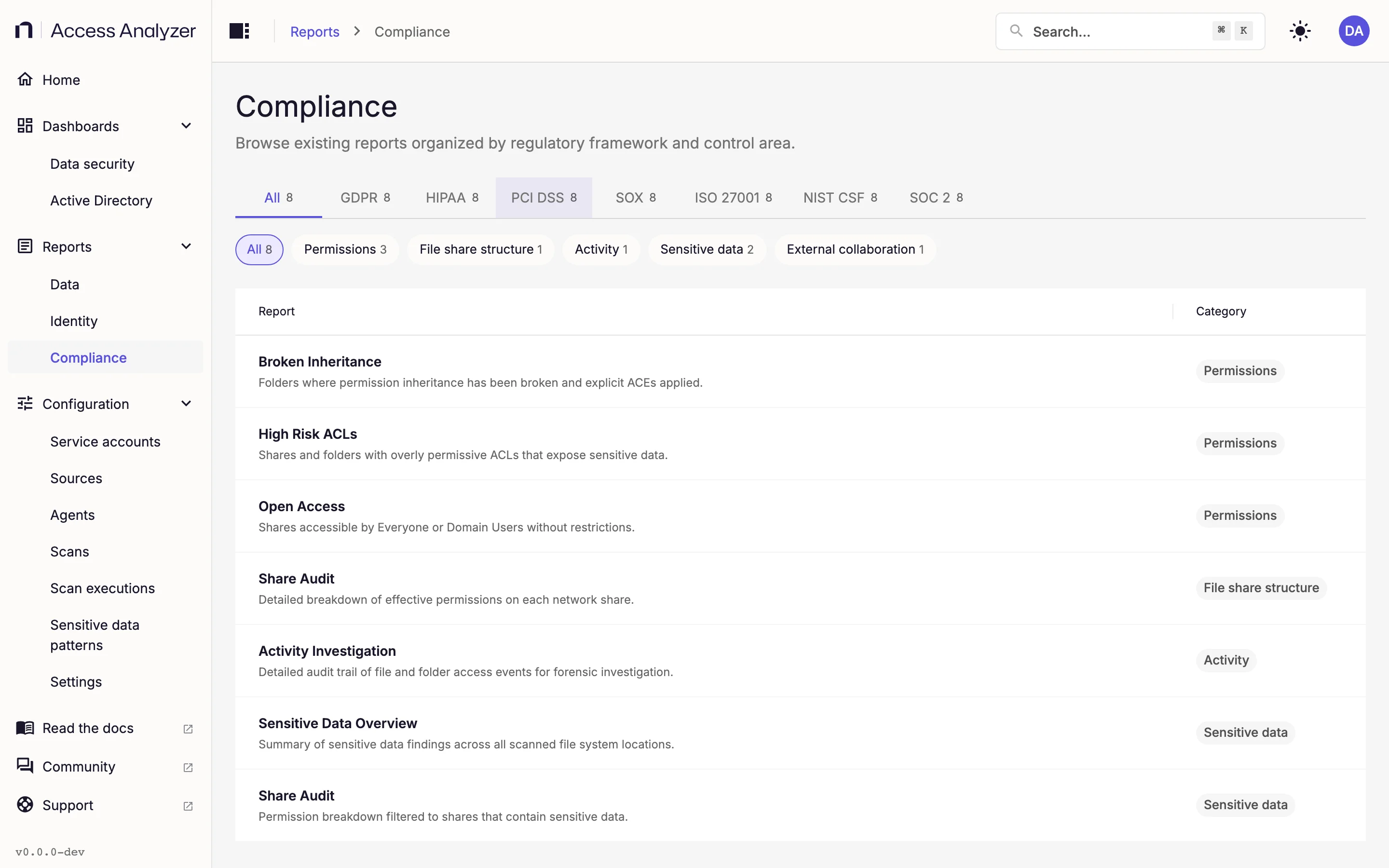

The layout matches the other two report pages: a table with Report and Category columns, tabs above it, and chips under the tabs. Here the tabs are regulatory frameworks and the chips are control areas.
The first tab, All, lists eight reports. One tab per framework follows, in this order:
| Tab | Framework |
| GDPR | General Data Protection Regulation |
| HIPAA | Health Insurance Portability and Accountability Act |
| PCI DSS | Payment Card Industry Data Security Standard |
| SOX | Sarbanes-Oxley Act |
| ISO 27001 | ISO/IEC 27001 information security management standard |
| NIST CSF | National Institute of Standards and Technology Cybersecurity Framework |
| SOC 2 | System and Organization Controls 2 |
Every framework tab lists the same eight reports, so each tab shows a count of eight. The frameworks carry no description text of their own; the tab label is all there is. What changes when you pick a framework is the badge next to each report name; see Primary and Supporting badges.
The chips group the eight reports by control area. The counts are the same on every tab.
| Chip | Reports |
| Permissions (3) | Broken Inheritance, High Risk ACLs, Open Access |
| File share structure (1) | Share Audit |
| Activity (1) | Activity Investigation |
| Sensitive data (2) | Sensitive Data Overview, Share Audit (the second Share Audit row on the Data page) |
| External collaboration (1) | Shared Links |
Both Share Audit rows from the Data page appear here, under different control areas. They open the same report. Switching tabs clears the selected chip, as on the other report pages.

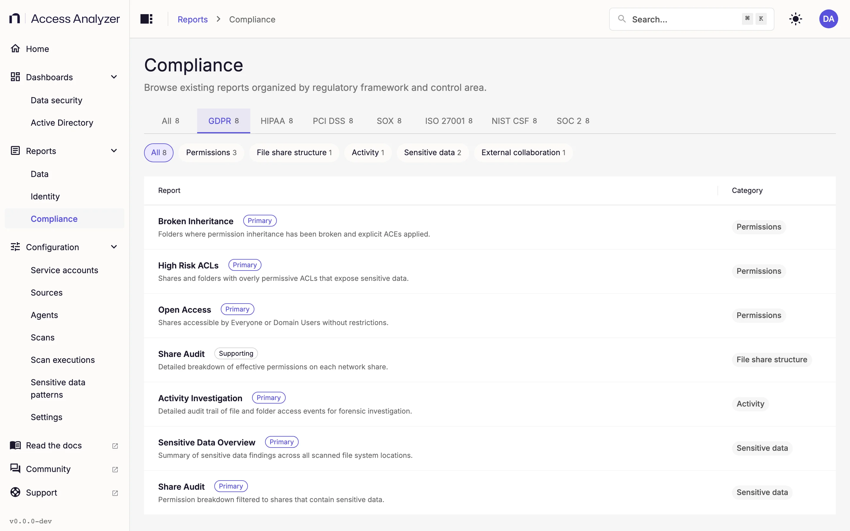

Primary and Supporting Badges
On the All tab, report names carry no badge. Select a framework and each name gains a small Primary or Supporting label. Primary means the report is direct evidence for that framework's controls; Supporting means it's useful context rather than the main exhibit.
Only two report-framework pairings carry the Supporting badge: the Share Audit row under File share structure on the GDPR tab and Shared Links under SOX. The second Share Audit row, under Sensitive data, is Primary on every tab, as is every other pairing. The badges are fixed, so they read the same in every deployment; they don't reflect anything about your data.
