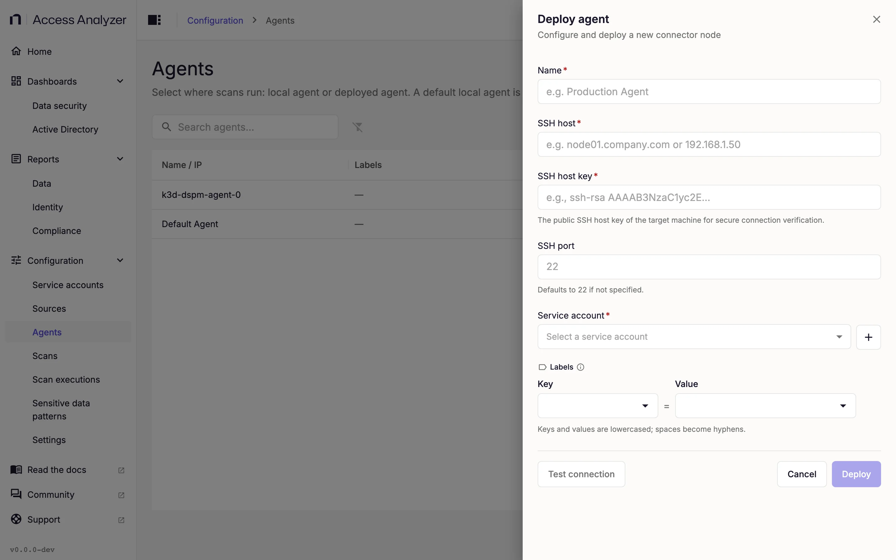

Deploy the Agent
Go to Configuration > Agents.
Click Deploy agent.
In Name, enter a name for the agent.
In SSH host, enter the hostname or IP address of the host.
In SSH host key, paste the host key you collected.
In SSH port, enter the SSH port if it isn't 22.
In Service account, select the SSH account. To create one now, click Add new service account.
Under Labels, add at least one label, such as
env=productionorregion=us-east. Labels are how scans find this agent; see Agent labels and scan routing. -
To check the host before installing anything, click Test connection and wait for Connection successful.
Click Deploy.
When deployment finishes, the panel closes, a notification reads Agent "<name>" deployed, and the agent appears in the list with its Health Status and Last Heartbeat.
Fields
| Field | What to enter | Rules |
| Name | A display name, for example Production Agent | Required; up to 255 characters |
| SSH host | Hostname or IP address, for example node01.company.com or 192.168.1.50 | Required; up to 255 characters; must be a valid hostname or IP address |
| SSH host key | The host's public key as <key-type> <key> | Required; must match the key the host presents |
| SSH port | The SSH port | Optional; 1 to 65535; defaults to 22 |
| Service account | An account of type SSH username/key | Required; the list shows only SSH accounts; Edit credentials opens the selected account |
| Labels | One or more key=value pairs | At least one required; keys and values are lowercased and spaces become hyphens |
If you close the panel with unsaved changes, Access Analyzer asks you to confirm.

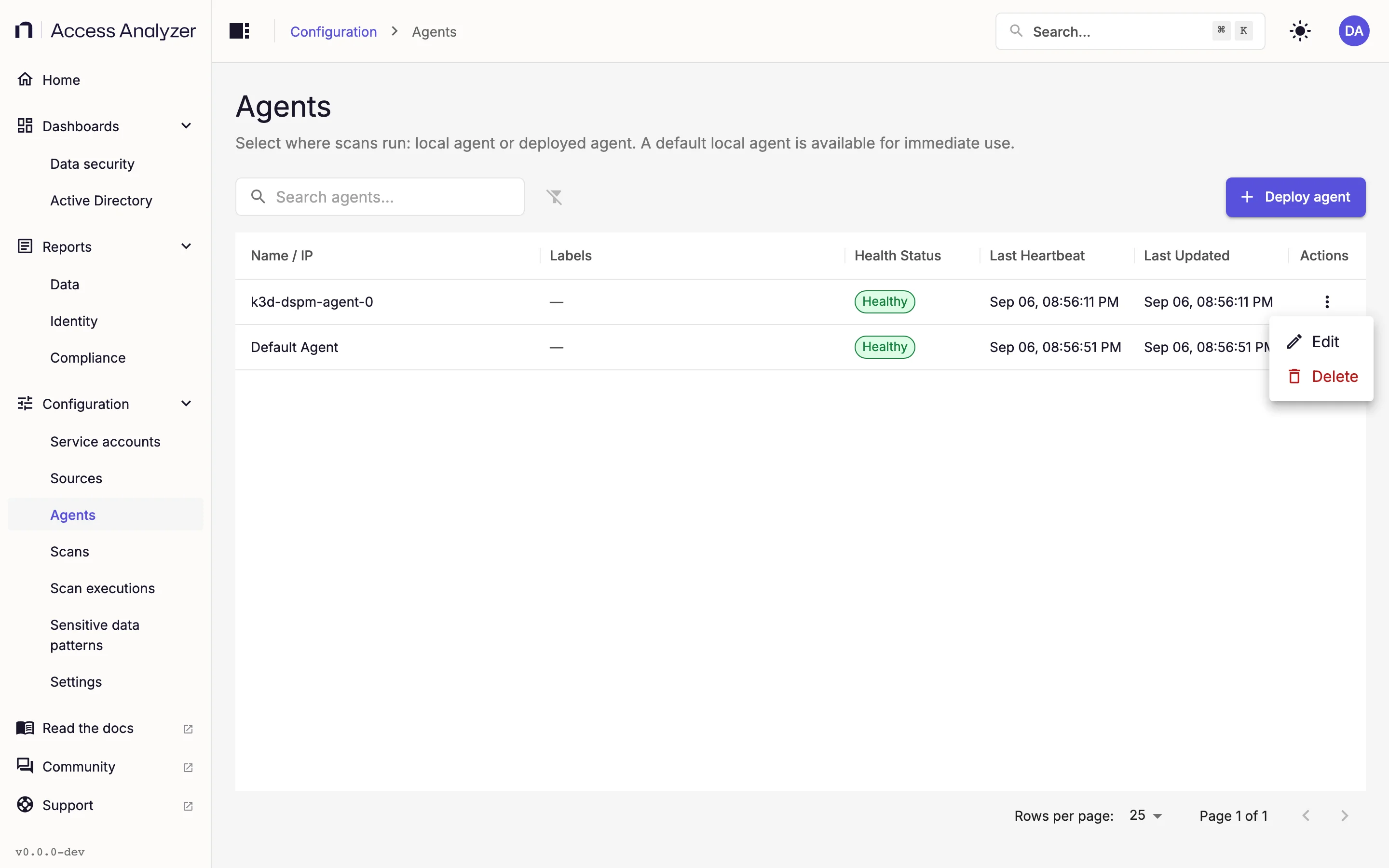

Edit an Agent

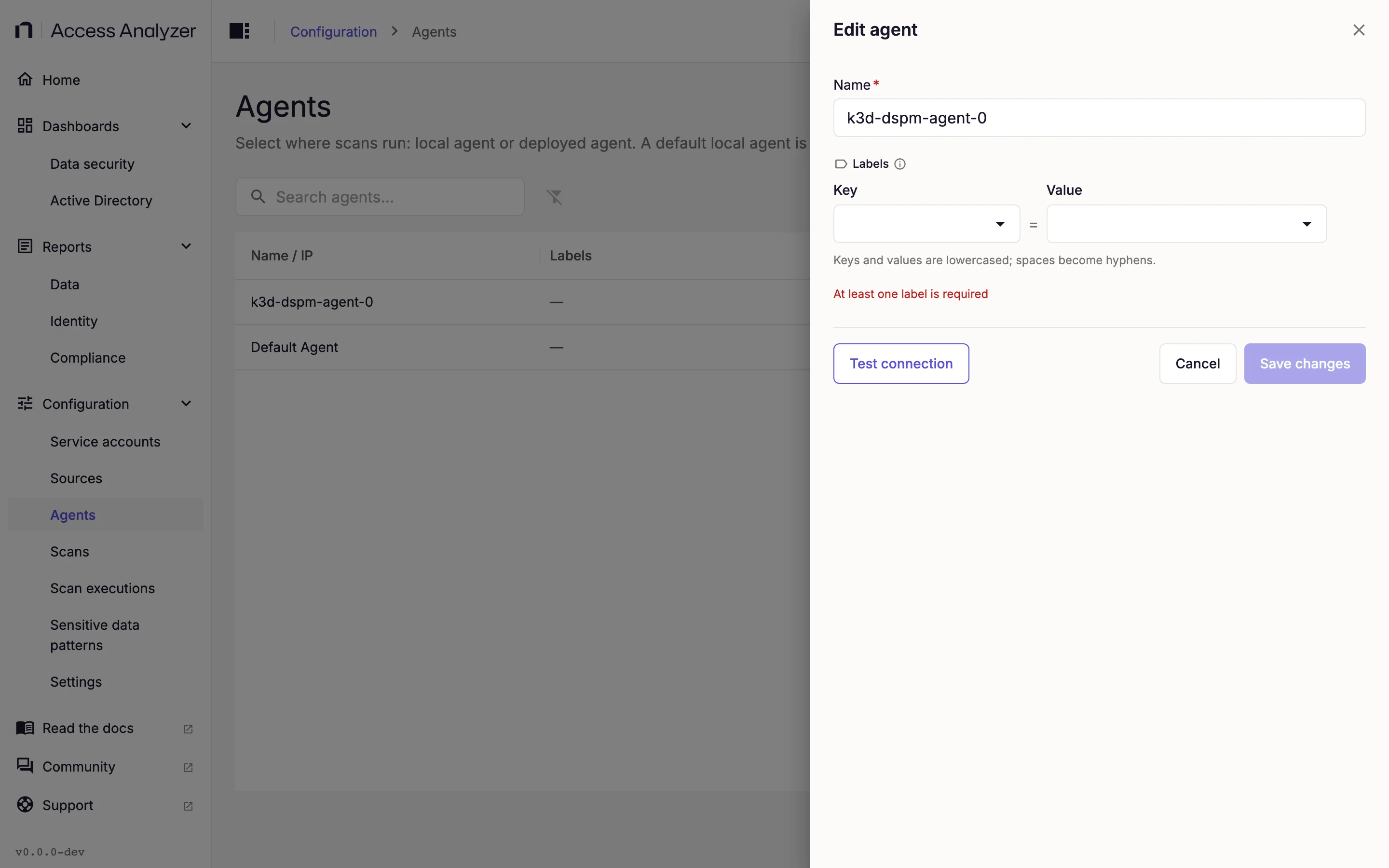

In the agent's Actions menu, click Edit.
Change the Name or the Labels. A deployed agent must keep at least one label.
Click Save changes.
The SSH fields don't appear when you edit. Access Analyzer uses SSH only to deploy the agent; after that, the agent talks to the server over its own connection and no longer needs the host key or service account.
Test connection works differently here: instead of checking the host over SSH, it sends a short test task through the agent and confirms it runs. It's a quick way to prove a deployed agent can accept work. Success shows Connection successful; a failure shows the server's message.
You can't rename or relabel the System agent, listed as Default Agent; opening Edit on it shows Name and Labels locked.
Remove an Agent
- Go to Configuration > Agents.
- In the agent's Actions menu, click Delete.
- Click Delete Agent to confirm.
A notification reads Agent "<name>" deleted, and the agent leaves the list.
