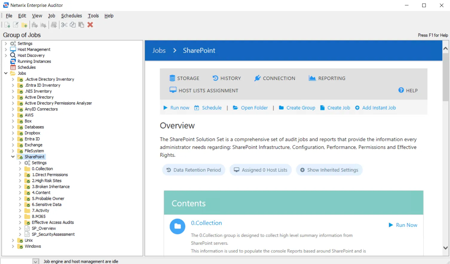

The SharePoint Solution requires a special Access Analyzer license. It can be installed from the Access Analyzer Instant Job Wizard. After it's installed into the Jobs tree, navigate to the solution: Jobs > SharePoint.
The 0.Collection Job Group collects the data. The other job groups and the SP_Overview Job run analysis on the collected data and generate reports.

This SharePoint solution offers information on multiple aspects of an organization’s SharePoint on-premises and SharePoint Online environments. This solution is comprised of 10 sub-job groups and an overview job which collect, analyze, and report on data. The data collection is conducted by the SharePoint Access Auditing (SPAA) Data Collector. See the corresponding Standard Reference Tables & Views for the SPAA Data Collector topic for database table information.

The SharePoint Solution is available with the SharePoint Reports license feature and is comprised of the following job groups and jobs:
  • 0.Collection Job Group – Designed to collect high level summary information from SharePoint servers. This information is used to populate the SMP Reports based around SharePoint and is a requirement for the Access Information Center – SharePoint reports.
    • This job group is available with the SharePoint license feature
  • 1.Direct Permissions Job Group – Provides insight into how directly applied permissions are configured within the SharePoint environment. The group contains surface-level configuration settings that can quickly assess the SharePoint permission structure.
  • 2.High Risk Sites > SP_OpenAccess Job – Provides insight into any high-risk repositories and high-risk data that may exist within an organization’s SharePoint environment. High risk data is effectively open to the entire organization through modification of SharePoint permissions to apply well known security principals such as NT AUTHORITY\Authenticated Users, Everyone, and Everyone Except External Users. This data must be monitored closely because of its exposure.
  • 3.Broken Inheritance > SP_BrokenInheritance Job – Keeping track of directly applied permissions at scale isn't realistic. This job is responsible for performing data analysis and generating SharePoint broken inheritance reports at the site level. This includes looking at site broken inheritance and the trustees who are assigned to those sites where inheritance is broken so that you can remove that access in favor of providing access via group membership.
  • 4.Content Job Group – Provides insight into content stored across SharePoint farms to help more efficiently manage that content. It will provide information about the largest content, content that hasn't been accessed in a long time, and additional data about SharePoint content and the configuration of repositories, such as lists and libraries, that store that content.
  • 5.Probable Owner > SP_ProbableOwner Job – Provides reports about probable ownership. The goal of this report is to help you either identify who most likely owns the SharePoint resource or at least someone who can tell you who does.
  • 6.Sensitive Data > SP_SensitiveData Job – Highlights sensitive data identified across targeted SharePoint farms
    • Requires Sensitive Data Discovery
  • 7.Activity Job Group – Generates summary and detail reports of SharePoint activity on the specified sites. Use these reports to identify file, folder, and user related activity across your SharePoint environment.
  • 8.M365 Job Group – Generates summary and detail reports of SharePoint Activity on the specified Teams sites. Use these reports to identify file, folder, and user related activity across your SharePoint environment.
  • Effective Access Audits Job Group – Returns reports identifying specific trustees’ effective access across the entire SharePoint environment
    • Typically, this is run independently from the rest of the solution
  • SP_Overview Job – Provides an overview of the SharePoint environment, providing a high level view into what makes up your SharePoint environment and the types of security risks and toxic permissions found during scans
