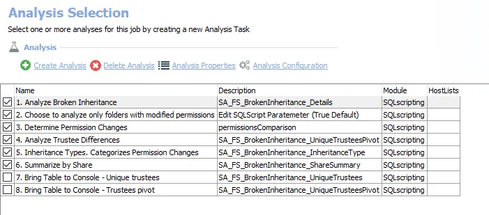

Analysis Tasks for the FS_BrokenInheritance Job
View the analysis tasks by navigating to the FileSystem > 3.Broken Inheritance > FS_BrokenInheritance > Configure node and select Analysis.
Most of these analysis tasks are preconfigured and shouldn't be modified and or deselected. There are some that are deselected by default, as they are for troubleshooting purposes.
  • 1. Analyze Broken Inheritance
    • Creates an interim processing table in the database for use by downstream analysis and report generation
    • Creates the SA_FS_BrokenInheritance_UniqueTrustees table accessible under the job’s Results node
    • Creates the SA_FS_BrokenInheritance_UniqueTrusteesPivot table accessible under the job’s Results node
  • 2. Choose to analyze only folders with modified permissions – Creates an interim processing table in the database for use by downstream analysis and report generation
    • By default set to only analyze resources with changed permissions from parent
    • Can be modified to analyze all resources regardless of permission changes between parent and child. See the Parameter Configuration topic for additional information.
    • Alternatively, this can be set by modifying the @FILTER_TO_CHANGED_RESOURCES parameter. See the Configure the Customizable Parameters in an Analysis Task topic for additional information.
  • 3. Determine Permission Changes – Creates an interim processing table in the database for use by downstream analysis and report generation
  • 4. Analyze Trustee Differences – Creates an interim processing table in the database for use by downstream analysis and report generation
  • 5. Inheritance Types. Categorizes Permission Changes – Creates an interim processing table in the database for use by downstream analysis and report generation
  • 6. Summarize by Share – Creates an interim processing table in the database for use by downstream analysis and report generation
The following analysis tasks are deselected by default:
  • 7. Bring Table to Console - Unique trustees – Restores the SA_FS_BrokenInheritance_UniqueTrustees table to be visible under the job’s Results node
  • 8. Bring Table to Console - Trustees pivot – Restores the SA_FS_BrokenInheritance_UniqueTrusteesPivot table to be visible under the job’s Results node
