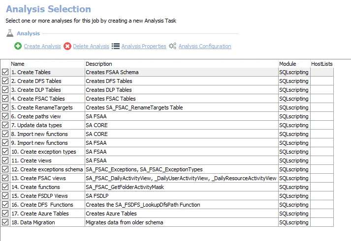

View the analysis task by navigating to the FileSystem > 0.Collection > 0-Create Schema > Configure node and select Analysis.
Analysis Selection for the 0-Create Schema Job
  • 1. Create Tables – Creates all tables prefaced with SAFSAA
  • 2. Create DFS Tables – Creates all tables prefaced with SAFSDFS
  • 3. Create DLP Tables – Creates all tables prefaced with SAFSDLP
  • 4. Create FSAC Tables – Creates all tables prefaced with SAFSAC
  • 5. Create Rename Targets – Creates the SA_FSAC_Rename Targets tables
  • 6. Create Paths View – Creates the SA_FSAA_Paths view
  • 7. Update data types – Access Analyzer uses custom SQL data types to render data. This analysis creates updates to those data types.
  • 8. Import new functions – Creates functions used in the File System Solution that only reference the .Active Directory Inventory job group data
  • 9. Import new functions – Creates the FSAA functions used in the File System Solution that reference the 0.Collection job group data
  • 10. Create exception types – Creates the SA_FSAA_ExceptionTypes table
  • 11. Create views – Creates the SA_FSAA_DirectPermissionsView
  • 12. Create Exceptions Schema – Creates the SA_FSAC_Exception table and the SA_FSAC_ExceptionTypes table
  • 13. Create FSAC Views – Creates all views prefaced with SAFSAC
  • 14. Create Functions – Creates the FSAC functions used in the File System Solution that reference the 0.Collection job group data
  • 15. Create FSDLP Views – Creates all views prefaced with SAFSDLP
  • 16. Create DFS Functions – Creates the FSDFS functions used in the File System Solution that reference the 0.Collection job group data
  • 17. Create Azure Tables – Creates tables for Azure Files
  • 18. Data Migration – Migrates data from an older schema version
