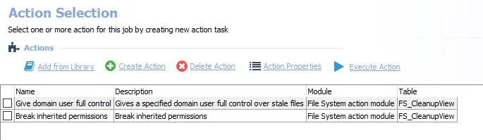

Navigate to the FileSystem > Cleanup > 3. Quarantine > FS_QuarantineData > Configure node and select Actions to view the action tasks.
Don't enable the actions unless they are required. Disable the actions after execution to prevent making unintended and potentially harmful changes to Active Directory.
Don't modify the action tasks. The action tasks are preconfigured for this job.
Action Tasks for the FS_QuarantineData Job
The following action tasks are deselected by default:
  • Give domain user full control – Gives a specified domain user full control over stale files
  • Break inherited permissions – Breaks inherited permissions
Before running the FS_QuarantineData job, select the Give domain user full control or Break inherited permissions task to perform an action.
