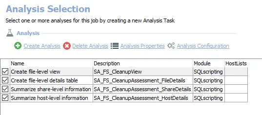

Analysis Tasks for the FS_CleanupAssessment Job
Navigate to the FileSystem > Cleanup > 1. Cleanup Assessment > FS_CleanupAssessment > Configure node and select Analysis to view the analysis tasks.
  • Create file-level view – Creates the SA_FS_CleanupView table accessible under the job’s Results node.
  • Create file-level details table – Creates the SA_FS_CleanupAssessment_FileDetails table accessible under the job’s Results node
  • Summarize share-level information – Creates the SA_FS_CleanupAssessment_ShareDetails table accessible under the job’s Results node
  • Summarize host-level information – Creates the SA_FS_CleanupAssessment_HostDetails table accessible under the job’s Results node

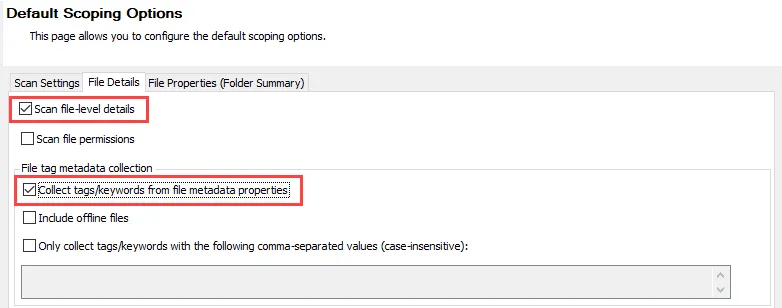

Include Metadata Tag Information
To include metadata tag information in the SA_FS_CleanupView table, the FileSystem > 0.Collection > 1-FSAA System Scans job needs configuring to use the required option. Follow the steps to enable the option on the File Detail Scan Settings page of the File System Scan query.
Step 1 – Navigate to the FileSystem > 0.Collection > 1-FSAA System Scans > Configure node and select Queries.
Step 2 – In the Query Selection view, select the File System Scan query and click Query Properties. The Query Properties window opens.

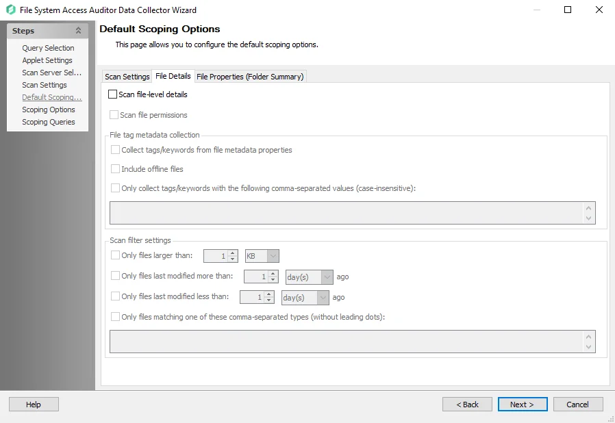

Step 3 – Select the Data Source tab, and click Configure. The File System Access Auditor Data Collector Wizard opens.
File Details tab of the FSAA Data Collector Wizard Default Scoping Options page
Step 4 – Navigate to the Default Scoping Options page and click the File Details tab.
Options to select on File Details tab
Step 5 – On the File Details tab, select the Scan file-level details option, and then select the Collect tags/keywords from file metadata properties option.
Don't make changes to other wizard pages as they have been pre-configured for the purpose of this job.
Step 6 – Navigate to the Scoping Queries page of the File System Access Auditor Data Collector Wizard and click Finish to save the changes and close the wizard.
Metadata Tag Information will now be included in the SA_FS_CleanupView table the next time the FS_CleanupAssessment job is run.
