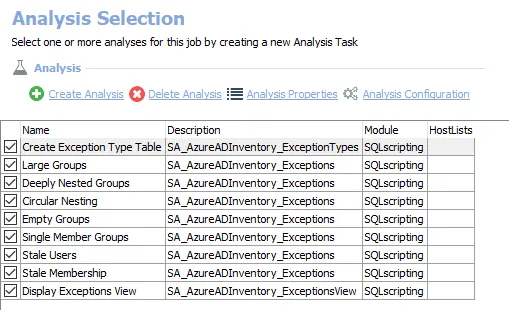

Analysis Tasks for the 2-AAD_Exceptions Job
Navigate to the .Entra ID Inventory > 2-AAD_Exceptions > Configure node and select Analysis. Analysis tasks with configuration parameters that define security concerns can be modified.
Most of these analysis tasks are preconfigured and shouldn't be modified or deselected. There are a few which are deselected by default, as they are for troubleshooting purposes.
Analysis Tasks for 2-AAD_Exceptions Job
  • Create Exception Type Table – Creates a processing table in the database for use by downstream analysis and report generation

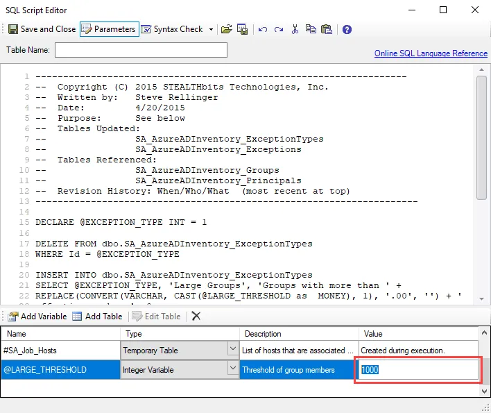

Customizable parameters enable Access Analyzer users to set the values used to classify user and group objects during this job’s analysis. The parameters can be customized and are listed in a section at the bottom of the SQL Script Editor. To customize an analysis task’s parameters:
Modifying these parameters affects solutions with .Entra ID Inventory Job Group dependency.

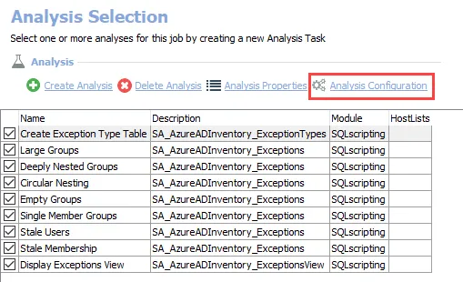

Step 1 – Navigate to the .Entra ID Inventory > 2-AAD_Exceptions > Configure node and select Analysis.
Analysis Configuration option on Analysis Selection page
Step 2 – In the Analysis Selection view, select an analysis task and click Analysis Configuration. The SQL Script Editor opens.
Step 3 – Click Parameters to open the Parameters section.
Change Parameter Value in SQL Script Editor
Step 4 – Double-click in a field in the Value column and enter a custom value.
Don't change any parameters where the Value states Created during execution.
Step 5 – Click Save and Close to finalize the customization and close the SQL Script Editor.
