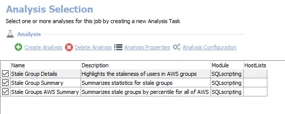

Analysis Tasks for the AWS_StaleGroups Job
Navigate to the AWS > 3.Groups > AWS_StaleGroups > Configure node and select Analysis to view the analysis tasks.
Don't deselect the selected analysis tasks. The analysis tasks are preconfigured for this job. Only modify the analysis tasks listed in the customizable analysis tasks section.
Stale Group Details – Highlights the staleness of users in AWS groups. Creates the AWS_StaleGroup_Details table accessible under the job’s Results node.
- The number of days without log in to consider an account stale can be customized. By default it is set to 60. See the Customizable Analysis Tasks for the AWS_StaleGroups Job topic for additional information.
Stale Group Summary – Summarizes statistics for stale groups. Creates the AWS_StaleGroup_Summary table accessible under the job’s Results node.
Stale Groups AWS Summary – Summarizes stale groups by percentile for all of AWS
