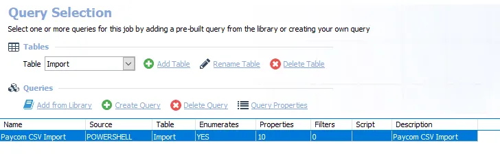

Step 1 – Navigate to the AnyID Connectors > AnyID_Paycom > Configure node and select Queries.
Step 2 – In the Query Selection view, select the Paycom CSV Import query and click Query Properties. The Query Properties window opens.

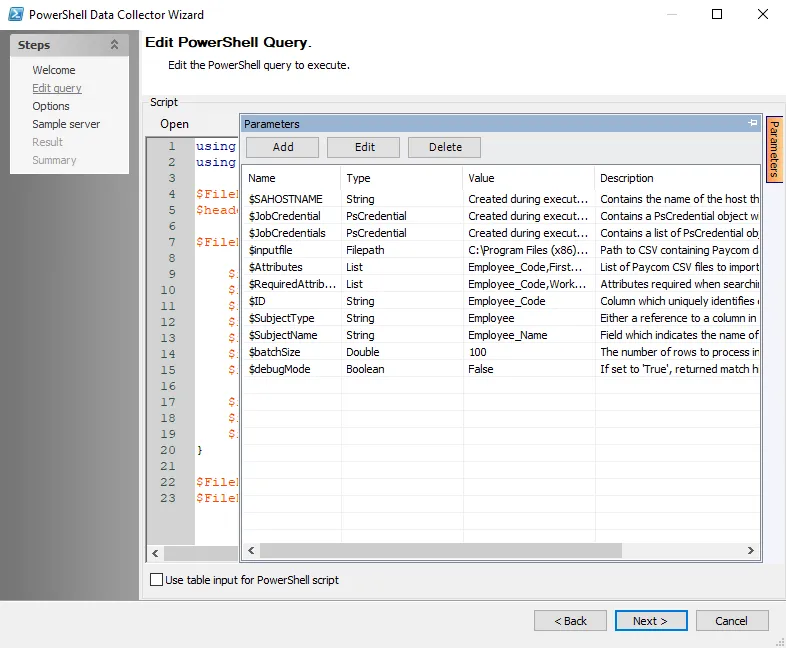

Step 3 – Select the Data Source tab, and click Configure. The PowerShell Data Collector Wizard opens.
Edit Query Page
Step 4 – Navigate to the Edit Query page. Click the Parameters tab on the right-hand side of the page to expand the Parameters window. See the PowerShell: Edit Query topic for additional information. Configure the following attributes as needed:
  • $SAHOSTNAME – Created during execution. This parameter can't be modified.
  • $JobCredential – Created during execution. This parameter can't be modified.
  • $JobCredentials – Created during execution. This parameter can't be modified.
  • $inputfile – File path to the CSV file which contains the identity and attribute information
  • $Attributes – The list of attributes that will be scanned for during sensitive data scanning
    • An attribute in the Attributes list will not be considered a match (in reporting and the Access Information Center (AIC)) unless an attribute in the RequiredAttributes list is also found in the same file
  • $RequiredAttributes – The list of attributes that need to be found in the document to trigger a match
    • An attribute in the Attributes list will not be considered a match (in reporting and AIC) unless an attribute in the RequiredAttributes list is also found in the same file
  • $ID – Column which uniquely identifies each subject
  • $SubjectType – Either a reference to a column in the csv file or a string which indicates the type of subjects being imported
  • $SubjectName – Either a reference to a column in the csv file or a string which indicates the name of the subjects being imported
  • $batchSize – The number of rows to process in a batch. Leave at default unless otherwise required.
  • $debugMode – When set to true, stores unhashed attribute values for troubleshooting purposes
Step 5 – Click Next. Continue to the Sample server page and click Finish to save changes. Click Cancel to exit the wizard without saving changes.
The query is now ready to run.

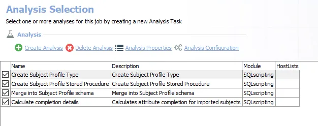

Analysis Tasks for the AnyID_Paycom Job
Navigate to the Jobs > AnyID Connectors > AnyID_Paycom > Configure node and select Analysis to view the analysis tasks.
  • Create Subject Profile Types – Creates subject profile types
  • Create Subject Profile Stored Procedure – Creates subject profile stored procedure
  • Merge into Subject Profile schema – Merges into subject profile schema
  • Calculate completion details – Calculates attribute completion for imported subjects
