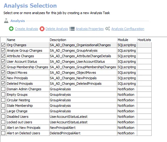

Analysis Tasks for the 2-AD_Changes Job
View the analysis tasks by navigating to the .Active Directory Inventory > 2-AD_Changes > Configure node and select Analysis.
  • Org Changes
    • Creates the SA_AD_Changes_OrganizationalChanges table accessible under the job’s Results node
    • Creates interim processing tables in the database for use by downstream analysis and report generation
  • Analyze Group Changes – Creates the SA_AD_Changes_GroupAnalysis table accessible under the job’s Results node
  • Attribute Changes
    • Creates the SA_AD_Changes_AttributeChangeDetails table accessible under the job’s Results node
  • User Account Status
    • Creates the SA_AD_Changes_UserAccountStatus table accessible under the job’s Results node
  • Group Membership Changes
    • Creates the SA_AD_Changes_GroupMembershipChanges table accessible under the job’s Results node
  • Object Moves
    • Creates the SA_AD_Changes_ObjectMoves table accessible under the job’s Results node
  • New Principals – Creates interim processing tables in the database for use by downstream analysis and report generation
  • Deleted Principals
    • Creates the SA_AD_Changes_DeletedPrincipals table accessible under the job’s Results node

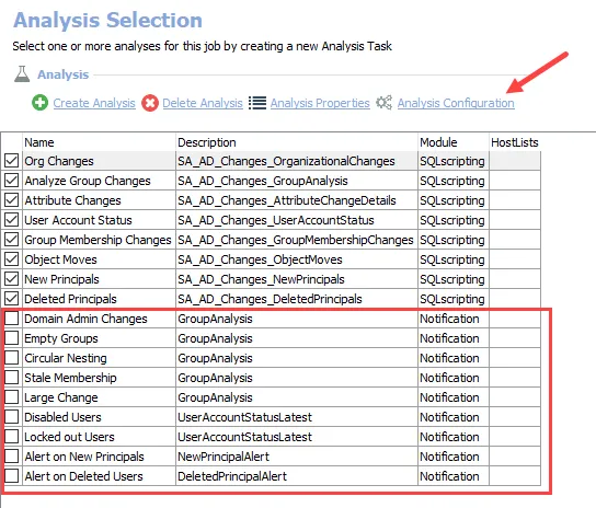

The Notification analysis tasks are optional and require configuration before enabling them. The following analysis tasks are deselected by default:
  • Domain Admin Changes – Alerts when Domain Admins Group membership changes occur
    • Importance – Security, as this is a Sensitive Security Group
  • Empty Groups – Alerts when group membership changes result in an empty group
    • Importance – AD Clean-up
  • Circular Nesting – Alerts when group membership changes result in a group effectively containing itself
    • Importance – Security and AD Clean-up
  • Stale Membership – Alerts when group members become stale
  • Large Change – Alerts when group membership changes result in a group becoming large
  • Disabled Users – Alerts when user accounts become disabled
  • Locked out Users – Alerts when user accounts become locked-out
    • Importance – Security  and Employee Productivity
  • Alert on New Principals – Alerts when new user, group, or computer objects are created
  • Alert on Deleted Users – Alerts when user accounts are deleted
Notification must have recipients configured for the analysis task. Optionally, the email subject and body can be modified. See the Notification Analysis Tasks for the 2-AD_Changes Job topic for additional information.

Step 1 – Navigate to the .Active Directory Inventory > 2-AD_Changes > Configure node and select Analysis.
Step 2 – In the Analysis Selection view, select the notification analysis task you want and click Analysis Configuration. The Notification Data Analysis Module opens.

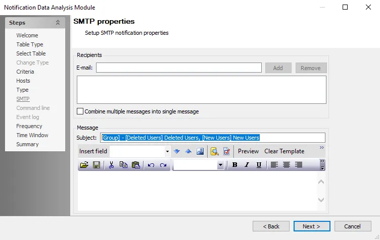

Notification Data Analysis Module SMTP properties page
Don't make changes to the pages preceding the SMTP page.
Step 3 – Use the Next button to navigate to the email configuration SMTP page.
Recipients section of SMTP properties page
Step 4 – In the Recipients section, provide the email addresses or distribution lists (fully qualified address) for those who are to receive this notification. Multiple addresses can be provided. You can use the following options:
  • Add – Add an email address to the E-mail field
  • Remove – Remove an email address from the Recipients list
  • Combine multiple messages into single message – Sends one email for all objects in the record set instead of one email per object to all recipients
Message section of SMTP properties page
Step 5 – In the Message section, edit the Subject. Don't remove any parameters. Then, customize the email content in the textbox to provide an explanation of the notification to the recipients.
Step 6 – Click Next to save these configuration changes and navigate to the Summary page. Do not make changes to any other pages. Click Finish. The Notification Data Analysis Module window closes.
Step 7 – This notification analysis task is now configured to send emails. In the Analysis Selection view, select the task checkbox.
Step 8 – Repeat this process for each desired notification analysis task.
