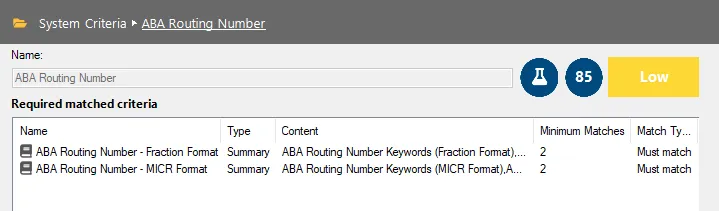

Options at the top of the configuration pane
The options at the top of the Configuration Pane are:
Configuration settings for System Criteria can't be modified.
  • Navigation Path – Displays information on the current location within the Sensitive Data Criteria Editor
  • Name – Name of the criteria as it is shown in the navigation pane
  • Test Criteria Button – Opens the Criteria Tester window to test current criteria configurations. See the Criteria Tester Window topic for additional information.
  • Confidence Level – Displays the current confidence level which indicates how accurate a match is for a criteria
    • The confidence level is reported on a scale from 0 - 100. The closer the number is to 100, the more accurate a match is for a criteria.
  • Risk Score – Displays the general level of risk a criteria represents when found in a file that is not properly secured
    • The risk score can be set to Low, Medium, or High
    • Click the Risk Score button to change the risk score for user-configured criteria
  • Required matched criteria list – Lists the sub-criteria configured for the selected top-level criteria in the navigation pane. The columns in the table are:
    • Name – Name of the sub-criteria
    • Type – Type of sub-criteria: Keywords, Regex, or Summary
    • Content – Values associated with the sub-criteria
    • Minimum Matches – Minimum number of match hits required for a sub-criteria match hit
    • Match Type – Displays whether the sub-criteria Must match or Must not match

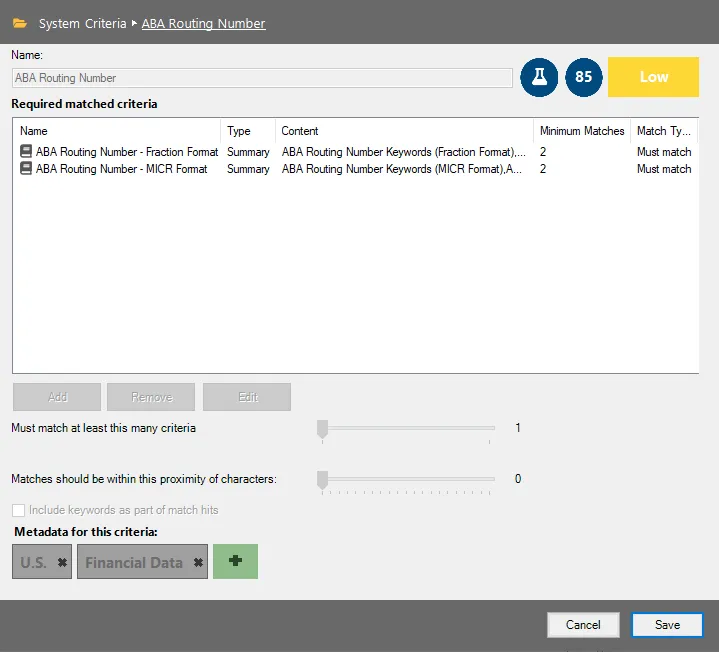

Options at the bottom of the configuration pane
The options at the bottom of the configuration pane are:
  • Add – Add a sub-criteria to the required matched criteria list. The three types of sub-criteria that can be added are Keyword, Pattern, and Summary. See the following topics for additional information:
  • Remove – Remove sub-criteria from the Required matched sub-criteria list
  • Edit – Edit the selected sub-criteria
  • Must match at least this many criteria – Adjust the slider to configure how many sub-criteria must be matched for the sensitive data criteria to be reported
    • The minimum value is 1
    • The maximum value is the number of sensitive data sub-criteria that has been added to the required matched criteria list
    The character distance feature doesn't account for summaries that are nested within other summaries.
  • Matches should be within this proximity of characters – Match hits for this criteria should be within this many characters of one another for there to be a match. Adjust the slider to set the default character distance required for match hits.
    • The minimum value is 0
    • The maximum value is 200
    • Using this feature requires any combination of two or more Regular Expression (Pattern) and Keyword sub-criteria
  • Include keywords as part of match hits – Select this option to include keywords in match hits. This option determines whether a match found based on a Keyword Criteria is reported as a match hit. When this option is selected, any matches found for a word in the Keyword list is reported as match hit. If this option isn't selected, then only matches found based on Pattern or child Summary Criteria are reported as a match hit.
  • Metadata for this criteria – Click the green plus (+) button to add a new metadata type for the criteria. Delete a metadata type by clicking the X button in the gray metadata tag.
  • Cancel – Exit the Sensitive Data Criteria Editor without saving changes
  • Save – Save changes made to the current criteria
