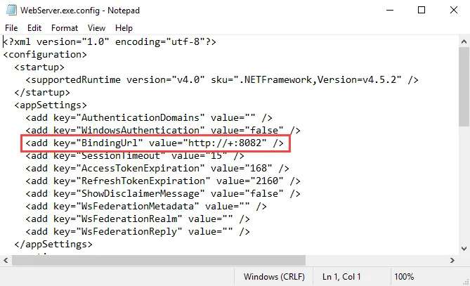

Step 3 – Open the WebServer.exe.config file with a text editor, for example Notepad. It is located within the Web folder of the Access Analyzer installation directory.
WebServer.exe.config file in Notepad
Step 4 – Change the value for the BindingUrl parameter from http to https:
<add key="BindingUrl" value="https://+:8082" />

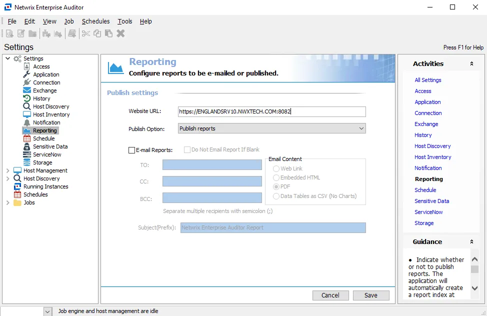

Step 1 – Expand Settings and select the Reporting node.
Access Governance Reporting Settings page
Step 2 – In the Website URL box, update the URL to: https://[hostname.domain.com]:8082
Step 3 – Click Save.
You have now updated the Website URL.

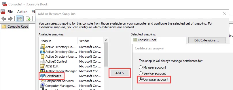

Step 2 – Select File > Add/Remove Snap-in. The Add or Remove Snap-ins window opens. Select Certificates, and click Add. Then select Computer account in the Certificates snap-in window.

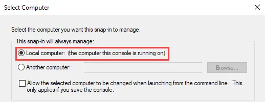

Step 3 – Click Next and select Local computer. Click Finish.

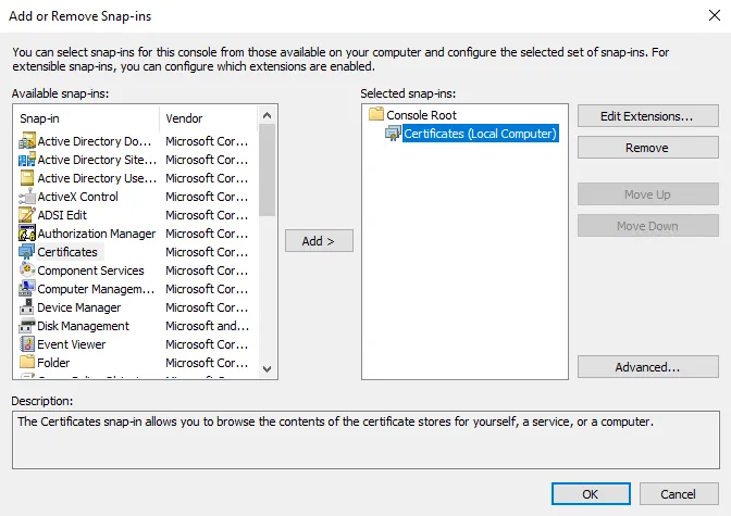

Step 4 – The certificate will appear in the Selected snap-ins list in the Add or Remove Snap-ins window. Click OK to close the window.
Step 5 – Navigate to Certificates > Personal > Certificates. The certificate should show in the pane on the right.

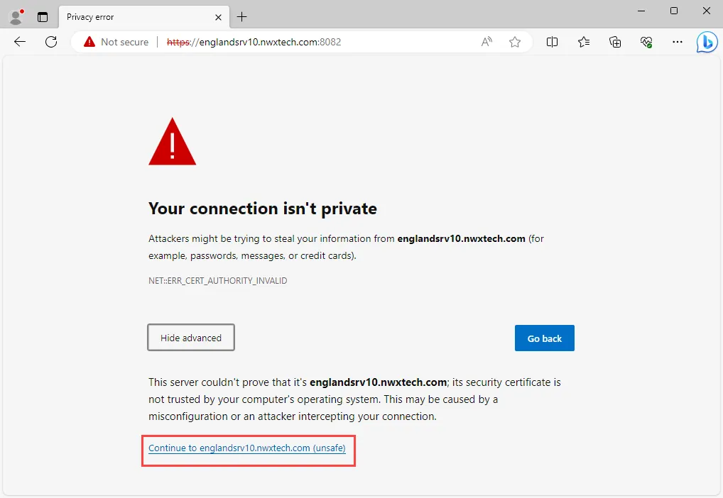

Step 2 – Click Advanced, and then use the link to continue to the site. This loads the main page of the Web Console.

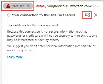

Step 3 – Click the Not Secure warning in the browser's address bar. Open the Certificate Viewer from the warning details.
  • In Microsoft Edge, click the Your Connection to this site isn't secure section, and then click the certificate icon.
  • In Google Chrome, click Certificate isn't valid.

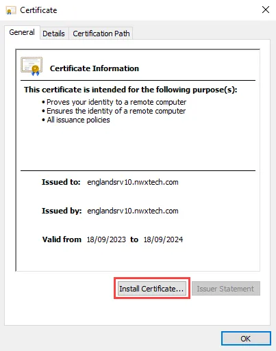

Step 5 – Navigate to the save location from the previous step and open the exported security certificate. On the Certificate window, click Install Certificate. The Certificate Import Wizard opens.

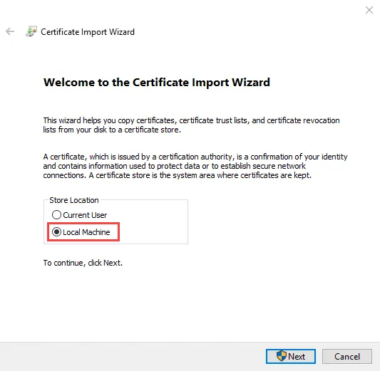

Step 6 – On the Certificate Import Wizard, select the Store Location as Local Machine, and click Next. Keep the default selection of Automatically select the certificate store based on the type of certificate. Navigate through the wizard to save this configuration. A pop-up message should state that the import was successful. Click OK to close out all dialogs.

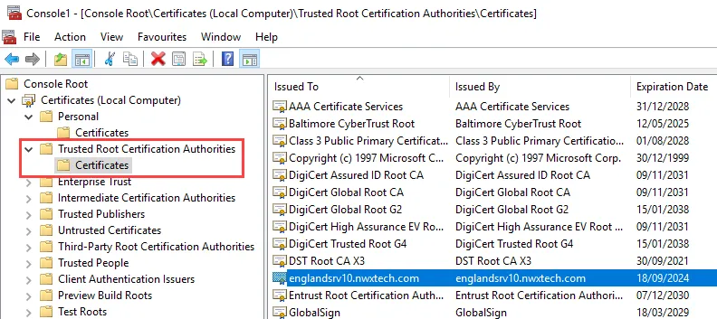

Step 7 – In the Microsoft Management Console, check the Trusted Root Certification Authorities > Certificates. The self-signed certificate should now appear there.
The client-side access to the Web Console will no longer generate a certificate error. Repeat these steps for each client-side host.
