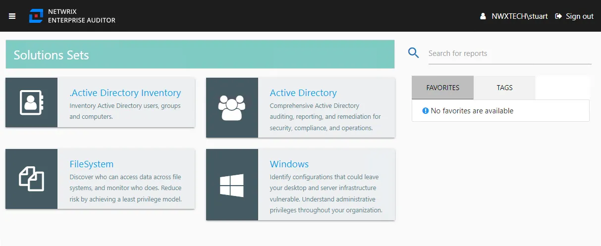

Web Console Home page
The home page shows the solutions with published reports available. See the Web Console topic for information on using the Web Console.
