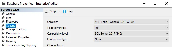

Change Collation at the Database Level
Step 1 – Access the Database Properties in SQL Server Management Studio.
SQL Server Management Studio Database Properties window
Step 2 – Select Options and set the collation.
Now that the collations match, proceed with Access Analyzer installation.

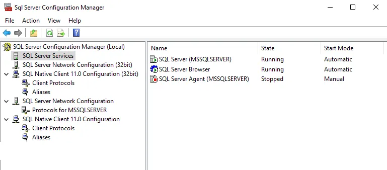

Change Collation at the SQL Server Level
SQL Server Configuration Manager
Step 1 – Stop the SQL Server service from the Configuration Manager.
Step 2 – Open CMD console as Administrator, and go to the following path (or the path where the binary files are):
…\Microsoft SQL Server\MSSQL11.MSSQLSERVER\MSSQL\Binn
Step 3 – Execute the following command (or whichever collation is needed):
sqlservr.exe  -m -T4022 -T3659 -q "French _CS_AS"
See the Microsoft Collation and Unicode support article for collation matches.
Step 4 – Wait until it finishes and start the SQL Server service again.
