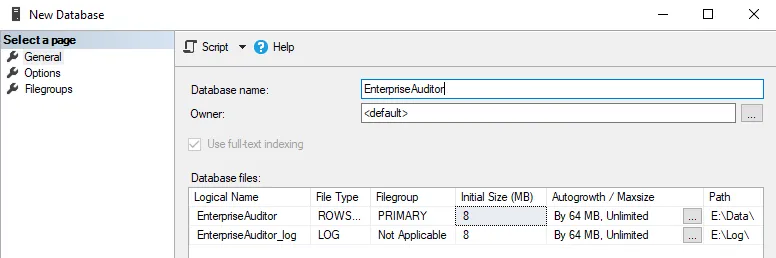

SQL Server Management Studio create New Database

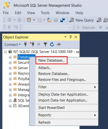

Step 1 – Create a new database for use with Access Analyzer. Right-click the Databases node and choose New Database.
SQL Server Management Studio New Database window
Step 2 – Set the Database name. Set any other desired data files configuration per company standards. Click OK on the New Database window.
info
Enter Access Analyzer as the Database name.

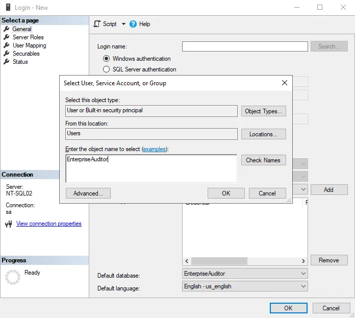

SQL Server Management Studio create New Login

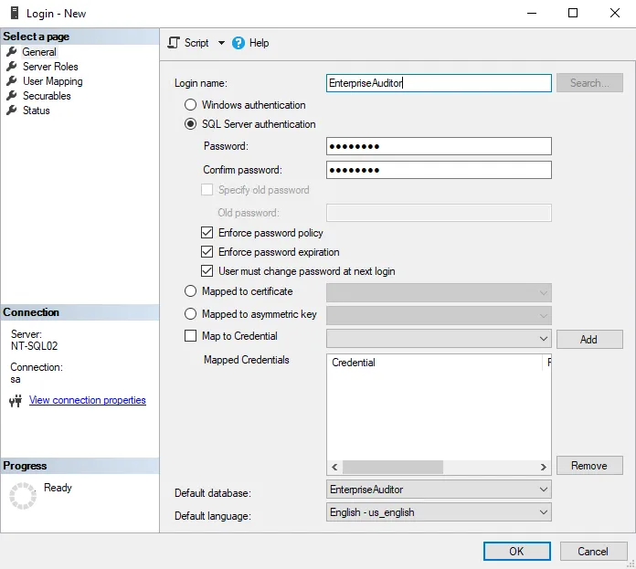

Step 3 – Create a new SQL Login account by right-clicking on the Security > Logins folder and selecting New Login.
Step 4 – Choose the authentication mode as the login type for use with the newly created Access Analyzer database. The available options are Windows authentication and SQL Server authentication.
SQL Server Management Studio new login with Windows authentication
  • If Windows authentication is desired, then click Search and select the Windows account that's set up for use with Access Analyzer.
SQL Server Management Studio new login with SQL Server authentication
  • RECOMMENDED: If SQL Server authentication is desired, use a login name called Access Analyzer.
Set the Default Database as Access Analyzer (or the Access Analyzer database you want) and choose English as the Default Language.

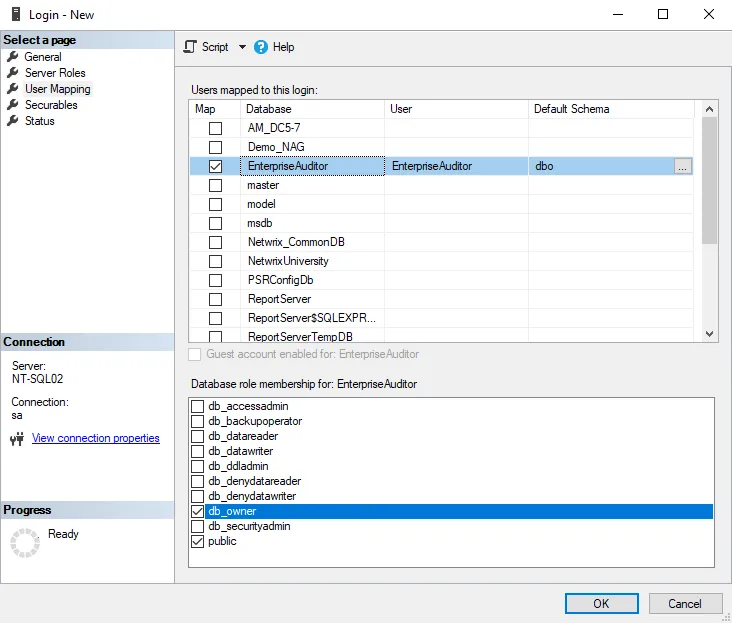

SQL Server Management Studio New Login User Mapping
Step 5 – Navigate to the User Mapping menu, select the Access Analyzer (or the desired Access Analyzer database) database, and set the Default Schema to DBO.
Step 6 – In the Database role membership section, set the role to db_owner. Click OK to save new user configuration information and continue on to configure the Access Analyzer Console.

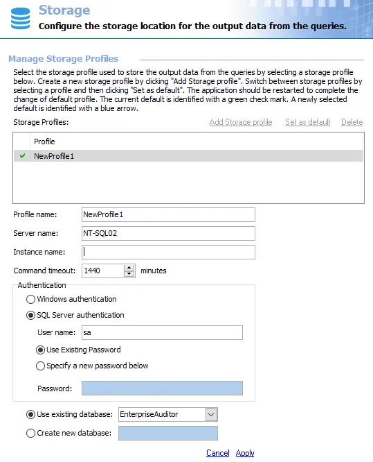

Storage Profile configuration page
Step 8 – Launch Access Analyzer and navigate to Settings > Storage.
  • Select the Storage Profile and enter the name of the SQL Server in the Server name field and Instance Name, if applicable.
  • Enter the name of the Access Analyzer database in the Use existing database field.
  • Choose the authentication method which matches the secure login that was created in Step 4, either Windows authentication or SQL Server authentication. If using SQL Server authentication, enter the User name and Password.

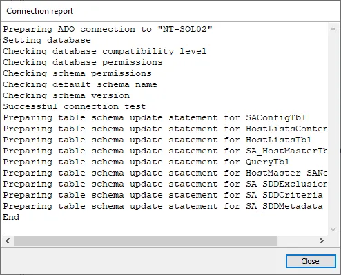

Connection report window
  • Click Apply and a Connection report window will open. Verify that Access Analyzer performed the connection and test table drop successfully.
  • Click Close on the Connection report window and then Save the new Storage Profile.

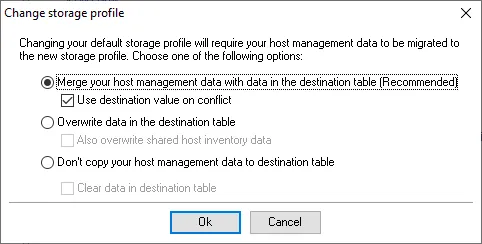

Change storage profile dialog
If previously connected to another database which already had the Access Analyzer DB schema applied, then a prompt should appear to merge the host management data. Choose the appropriate options and then click OK to migrate data.
