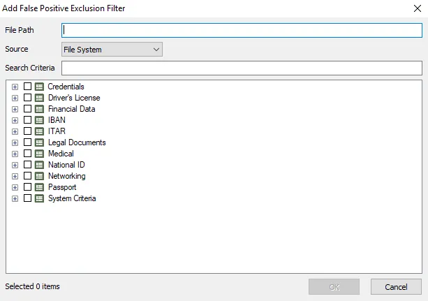

Step 1 – Click Add Filter to open the Add False Positive Exclusion Filter window.
Step 2 – Enter the File Path using the format required for the repository type.
Step 3 – Indicate the type of repository by selecting either File System or SharePoint from the Source dropdown menu.
Step 4 – Select the required criteria from the list by checking the relevant boxes. You can use the Search Criteria textbox to filter the list by keyword.
Step 5 – Click OK to add the filter to the False Criteria list. The Add False Positive Exclusion Filter window closes.
