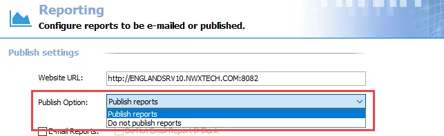

Publish Option
Use the Publish Option to enable or disable the publishing of reports at the global level.
Publish Option on Global Settings Reporting page
Select the Publish reports option to publish all Access Analyzer reports or select Don't publish reports to disable the publishing. The inheritance of this setting can be broken at the job group, job, or report levels.

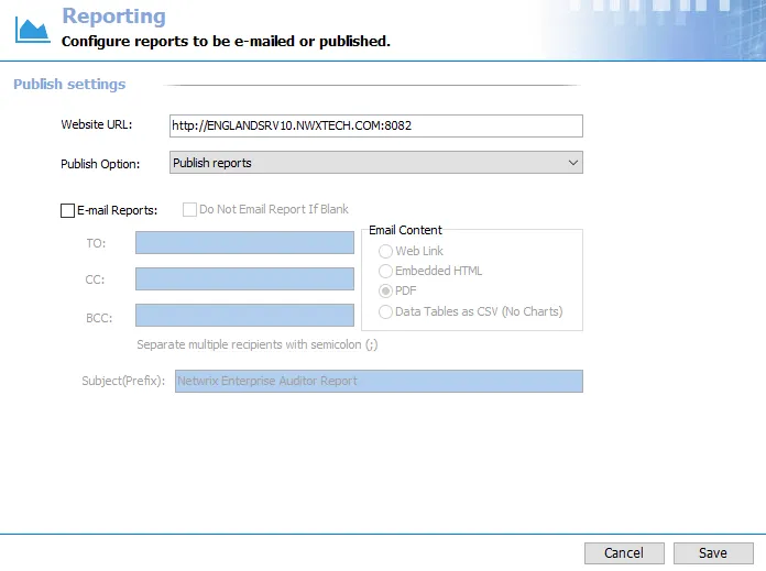

Email Report Options
Configure email reports sent out by Access Analyzer using the Email Report options.
Email options on Global Settings Reporting page
The E-mail reports checkbox enables recipients to receive all published reports, unless direct assignment at the job group, job, or report level breaks the inheritance. Separate multiple recipients with a semicolon. If you use commas to delimit email addresses, Access Analyzer converts them into semicolons when you save the settings.
info
Configure email reporting at a specific level to ensure recipients only receive reports which apply to them.
Email reports doesn't work unless you configure Access Analyzer to send email notifications through the Notification node. See the Notification topic for additional information.
The Don't Email Report If Blank checkbox stops Access Analyzer from sending reports by email if all elements are blank when generated. A blank report can occur if there is an error in data collection or if you configured the report for data that might not always be present (for example, new computer objects created since last scan).
info
Enable the Don't Email Report If Blank option.
You can send the report using the Email Content option you want:
  • Web Link – Sends an email notice that the report has been published and provides the recipient with a link to it in the Web console
  • Embedded HTML – Sends the report embedded inside the email using HTML format
  • Data Tables as CSV (No Charts) – Attaches the complete data set (as configured within the report, without row limit) to an email as a CSV file, excluding any charts
  • PDF – Attaches the report to an email as a PDF file
The Subject(Prefix) field identifies the prefix of the email subject line, unless direct assignment at the job group, job, or report level breaks the inheritance. The prefix appears in the email header preceding the report name. If left blank, Access Analyzer applies a prefix of Access Analyzer Report to the email subject line.

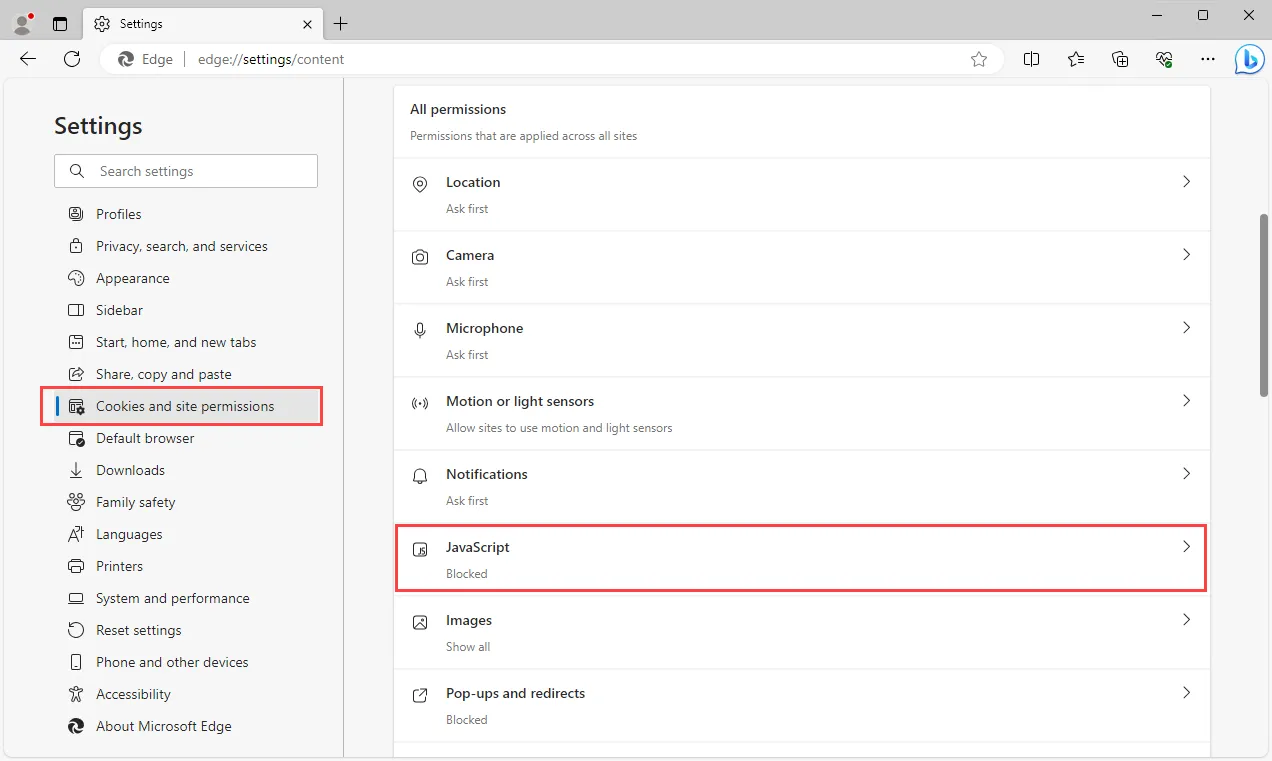

Configure JavaScript Settings for the Web Console
Any browser used to access the Web Console must have JavaScript allowed for all features of the Web Console to function correctly. If the JavaScript permission isn't set as allowed for the entire browser, you must add the Web Console as an allowed site.
Follow the steps to allow JavaScript on the Web Console in Microsoft Edge.
Step 1 – Open Microsoft Edge Settings.
javascriptsitepermissions
Step 2 – Go to the Cookies and site permissions settings page, and click JavaScript under All permissions.
javascriptsettings
Step 3 – Click Add in the Allow section. On the Add a site window, enter the URL for the Web Console and click Add.
If you select the global Allowed option, you don't need to specifically add the Web Console as an allowed site.
Microsoft Edge adds the Web Console's URL to the Allow list and enables JavaScript for the Web Console.
