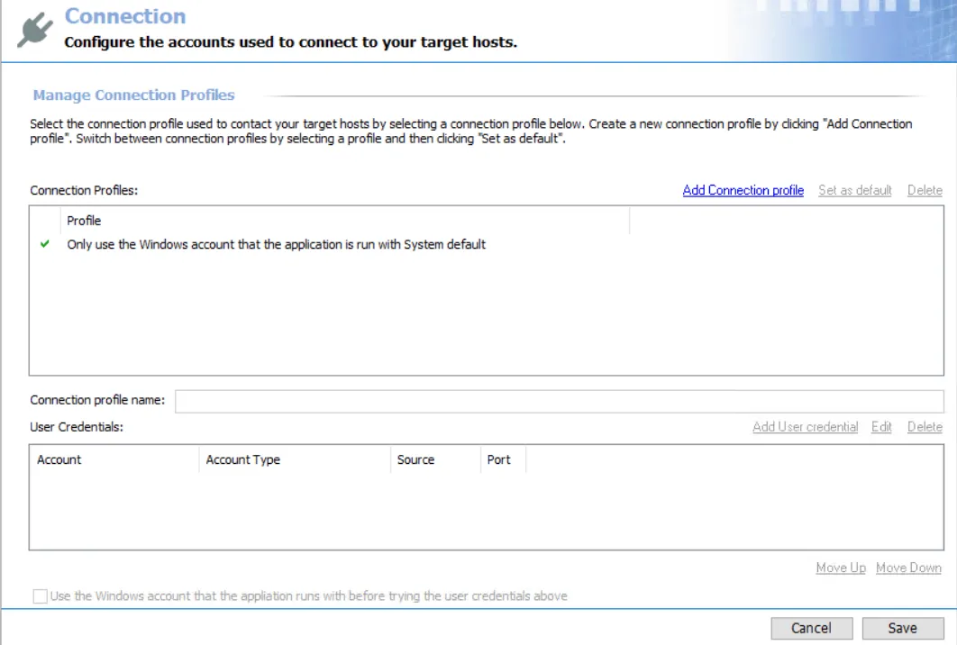

Connection
The Connection node contains objects referred to as Connection Profiles. A Connection Profile houses the information Access Analyzer uses to connect to the target hosts during job execution.
Connection
You can authenticate to a targeted host using one of two methods:
  • Use Local Login Credentials
  • Use a Connection Profile

Cancel and Save options
The Cancel and Save buttons are in the lower-right corner of the Connection view. These buttons become enabled when you modify the Connection global setting.
Information update message box
Whenever you make changes at the global level, click Save and then OK to confirm the changes. Otherwise, click Cancel if you didn't intend to make changes.
