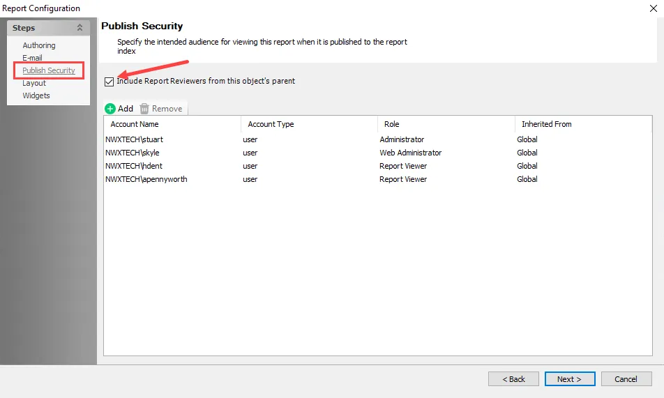

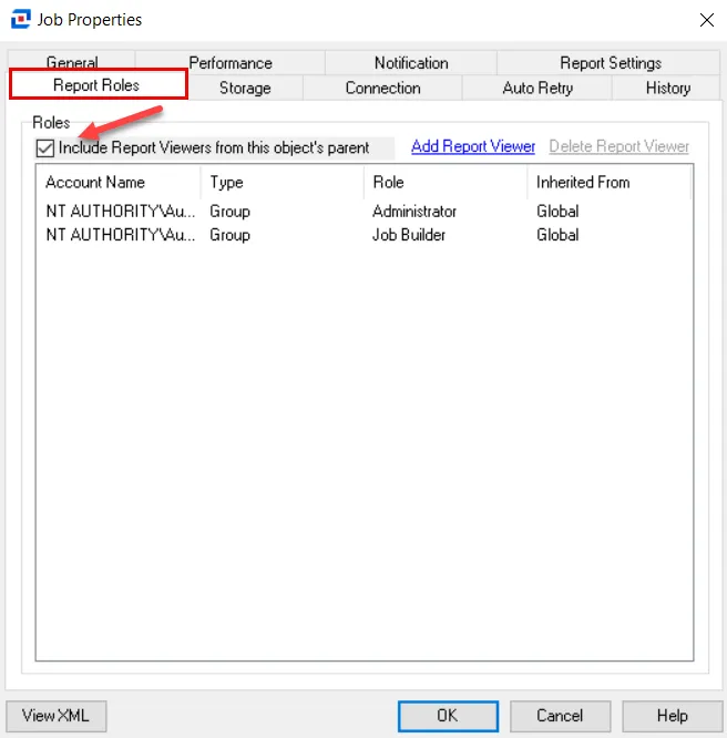

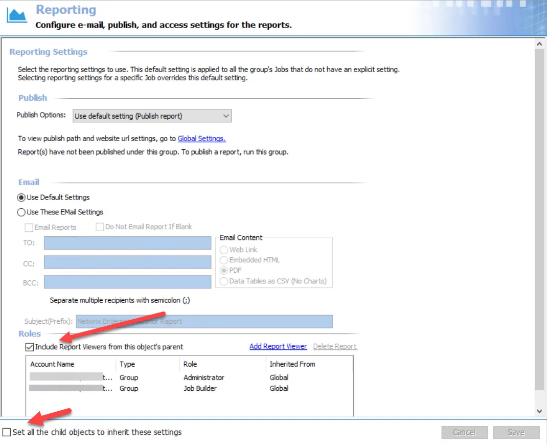

You can assign additional users the Report Viewer role at the global, job group, job, or report configuration levels. Child objects inherit these rights. However, you can break the Report Viewer role inheritance at any level. Break inheritance to remove the right to view specific reports at:
- Job Group level – [Job Group] >Settings > Reporting node
- Job level – [Job] > Properties >Report Roles tab
- Report Configuration level – [Job] > Configure > Reports node. Click Configure next to the report, and navigate to the Publish Security page of the Report Configuration wizard. See the Publish Security Page topic for additional information.
Job Group Level
Job Level
Report Configuration Level
There are two options that control inheritance for Report Viewers when selected:
- Include Report Viewers from this object’s parent – Automatically removes any user with the Report Viewer role inherited from a parent object at the lower levels
- Set all the child objects to inherit these settings – Only available at the Job Group level. Sets all Jobs and Reports to inherit group settings for all child objects by automatically selecting the Include Report Viewers from this object’s parent option. Access Analyzer overwrites any previous configurations after you select Yes in the confirmation window.
