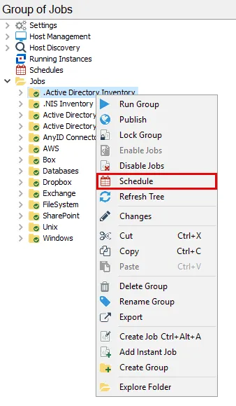

Schedule Jobs
Jobs can be scheduled at the job group or job level.
Schedule option from Job Tree
Select the job group or job you want. Right-click the node and select Schedule to open the Schedule wizard.
Schedule Job wizard
