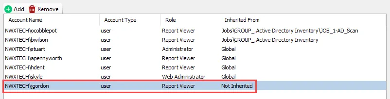

You can add additional users, groups, and service accounts with the Report Viewer role at the Report level. This gives them the permission to view the specific report in the Web Console. Follow the steps to add an account.

Report Viewer user added in wizard
The selected account is added to the list with a Role of Report Viewer.
The permission for accounts that aren't Inherited can also be removed using the wizard. To remove an account, select it and then click Remove.
