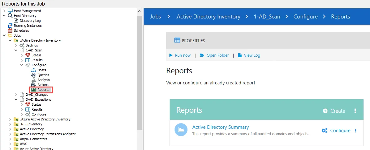

Reports node
The Reports node, contained within a job’s Configure node, lists any reports that are configured for the job. The page contains options to create a report, configure existing reports, and a link to view generated reports. The configuration of reports vary by use case, but they contain the same elements. The layout and elements of a report are configured using the Report Configuration Wizard.
