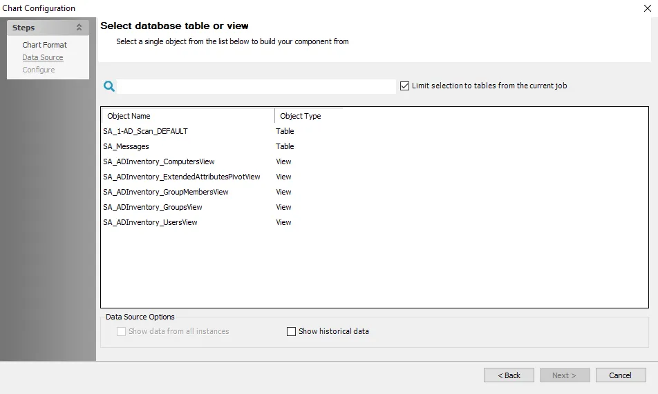

Data Source
On the Data Source page of the Chart Configuration wizard configure the data source for the chart.
Chart Configuration wizard Data Source page
to generate results, a location must first be selected as the source of the data. The table on this wizard page contains a list of tables and views within Access Analyzer from jobs that have been executed. Select the required data source from the table.
You can use the search bar located above the table to find a specific table. The Limit selection to tables from the current joboption limits the displayed data to tables from the current job. This option is selected by default. You can clear the option to widen the available data to all jobs.
There are the following additional data source options:
  • Show data from all instances – Select this option to display data from all Access Analyzer data jobs
  • Show historical data – If there is historical data, selecting this option displays all collections. It is keyed off of the Jobruntimekey column.
After you select the data source, click Next to proceed to the Configure page. See the Configure topic for additional information.
