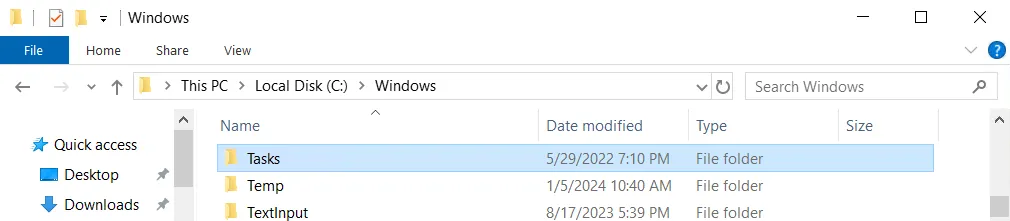

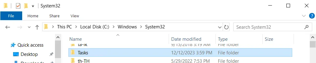

Step 3 – Back up all Scheduled Tasks. The method of back up is determined by the Access Analyzer user. For example, you can copy the contents of the tasks folder from the following two locations:
C:\Windows\Tasks
  • C:\Windows\Tasks
C:\Windows\System32\Tasks
  • C:\Windows\System32\Tasks

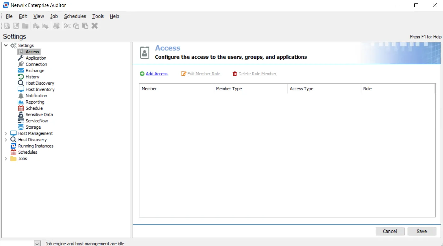

Step 7 – Enable Role Based Access to write the necessary registry keys:
Role Based Access
  • Navigate to the Settings > Access node in the Access Analyzer Console and select Access
  • Use the Add Access, Edit Member Role, and Delete Member Role buttons to add, remove, and edit roles
  • See the Role Based Access topic for more information
