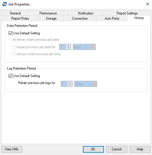

History Tab
The History tab is for configuring the Data Retention and Log Retention periods. Choose either to use the default settings, which could be either the global configuration or configuration set via broken inheritance at a job group level, or to configure settings just for this job.
History tab of the Job Properties
By default, all jobs are set to inherit the Data Retention Period and Log Retention Period settings, the Use Default Setting option. Deselect the Use Default Settings option to configure custom settings for the job. Then provide the Data Retention Period and Log Retention Period settings you want. See the History topic for additional information.
Click OK to save configuration changes and close the Job Properties window. Click Cancel if no changes were made.
