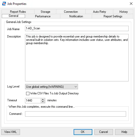

General Tab
The General tab is for changing the job name and description.
General tab of Job Properties
The following options are available:
  • Job Name
  • Description
  • Log Level – Indicates the job log level, which can be inherited from the global Settings > Application log level or customized here. See the Log Level topic for additional information.
  • Write CSV Files To Job Output Directory – Exports the native data table created by a query to a CSV file in the job’s output directory. If there are multiple tables in the job, this option creates one file per table.
  • Timeout [value] minutes – Job’s thread timeout value
  • Command – lets you enter a command that will be executed from the command line upon job completion

You can switch between log levels. All the levels, including the one that you choose, shall be set for messaging in the application.
Log Level Options
For example, this is where you set the messaging for Info, Warning, or Error at a job level.
