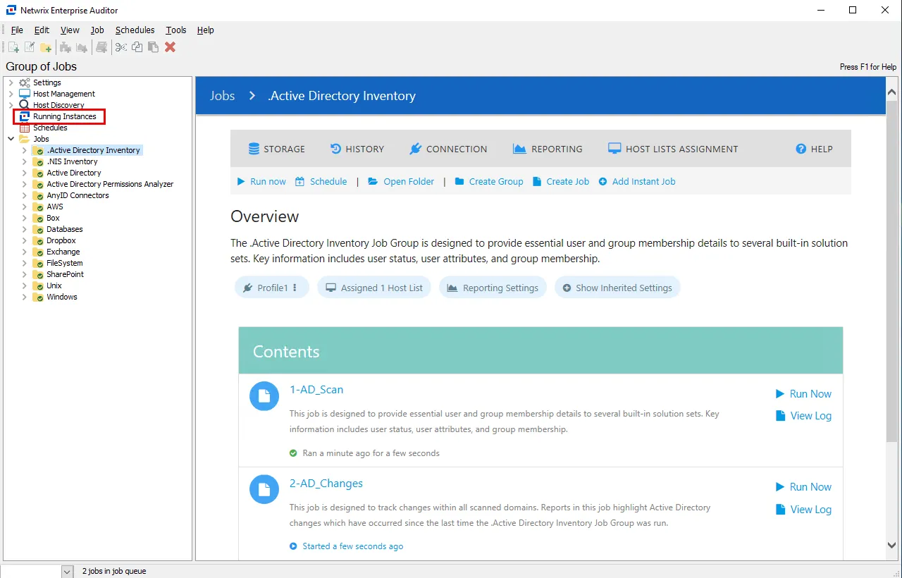

Once a job has been configured and is being executed, job progress can be viewed at the Running Instances node on the Navigation pane. See the Running Instances Node topic for additional information.
Running Job
At the bottom of the Access Analyzer Console, there is an indication of how many jobs are in queue and the View Job Progress link, which opens the Running Instances node.

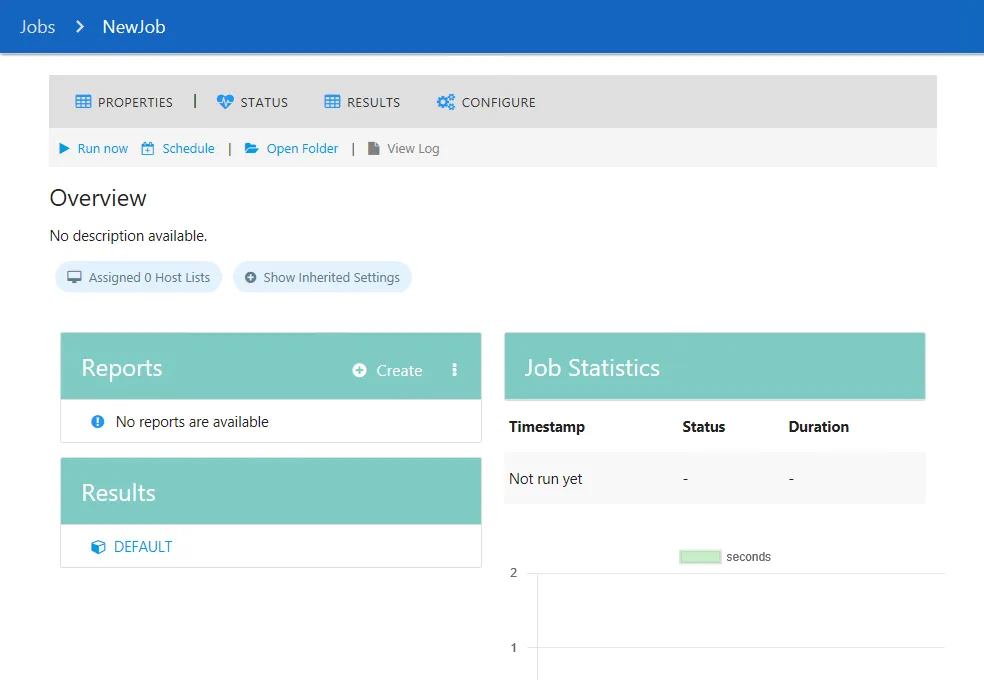

Job Description Page
The Job Description page displays shortcuts, links, and important information on the job. The Job Page lets users view and modify common job configurations, such as Connection and Storage profiles, job properties, SQL analysis parameters, and PowerShell parameters. Depending on the type of job, the description page will appear different and display information specific to the job selected.
Pre-Configured Job Description pageUser-Created Job Description page
Pre-Configured JobUser-Created Job
The two types of Job Groups in Access Analyzer are:
  • Pre-configured – The job description page provides a brief summary of the purpose of the job, the reports and data contained within it, and summary information of the last five times the job was executed
  • User Created – The job description page of User Created jobs will be blank until the job is configured
Pre-configured job description pages provide users with shortcuts and links to many of the functions that can be accessed under the [Job Group] > [Job] node in the Jobs Tree in the Navigation Pane.

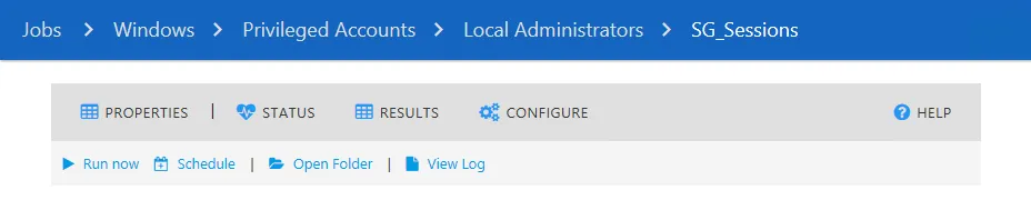

Job Description page options
The sections and options of the job description page are:
  • Properties – Opens the Job Properties window. See the Job Properties topic for additional information.
  • Status – Opens the job Status page. See the Status Node topic for additional information.
  • Results – Opens the job Results page. See the Results Node topic for additional information.
  • Configure – Opens the job Configure page. See the Configure Node topic for additional information.
  • Run Now – Executes the job
  • Schedule – Opens the Schedule Wizard
  • Open Folder – Opens the job folder location with supporting files in the Windows Explorer
  • View Log – Opens the job’s log

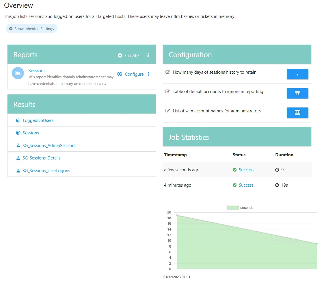

Job Description page Overview section
The Overview section provides summary information about the job, and includes the following information:
  • Inherited settings – Job settings can be applied directly or inherited from a parent job group or even the General Settings level. See the Jobs with Inherited Settings topic for additional information.
  • Reports – Displays a list of reports that this job generates
  • Results – Displays a list of data tables and views created and populated by the job
  • Configuration - If applicable, configure parameters for the job's analysis tasks
  • Job Statistics – Displays important information for the last five times the job was executed including:
    • Timestamp – Date timestamp of when job was initiated
    • Status – Displays information on job status (Running, Success, Error)
    • Duration – Displays length of time each job took
  • Graph – Displays a line graph that has information for the last five times the job was executed

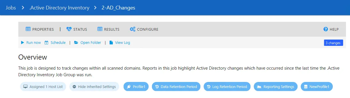

Job settings can be applied directly or inherited from a parent job group or even the General Settings level. If settings are applied directly to a job, these are shown in the Overview section under the job description:
Job Inherited settings
In the preceding example, the Assigned 1 Host List setting is applied directly to the job. Other settings are inherited from the parent job group. Clicking the Show inherited settings button opens this list of the inherited settings.

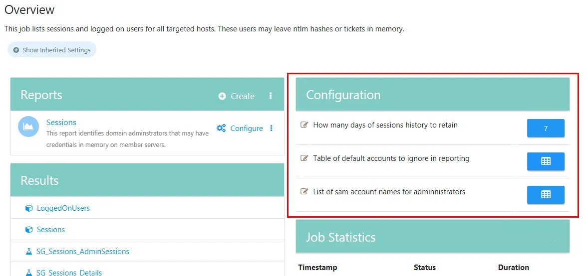

Parameter Configuration
If a job has analysis parameters that can be customized, those parameters can be configured in the Configuration section of the Job Description Page.
To configure customizable parameters using the Configuration option on the Job Description Page:
Step 1 – Navigate to the Jobs > [Job Group] > [Job] node. If the job has customizable parameters, they will be located under Configuration in the job's Overview section.
Configuration section of Job description page
Step 2 – Click a parameter to open the Parameter Configuration window.
To view a tool-tip that contains information about the Variable Name and the Task Name that the parameter is associated with, hover the mouse over the parameter.
Parameter Configuration Window
Step 3 – Configure the parameter in the Parameter Configuration window. Click Save to save changes and exit the window. Click Cancel to exit without saving.
The parameter has now been configured. The parameters can also be configured in the Analysis Node under the job's Configure Node. See the Analysis Node topic for additional information.
