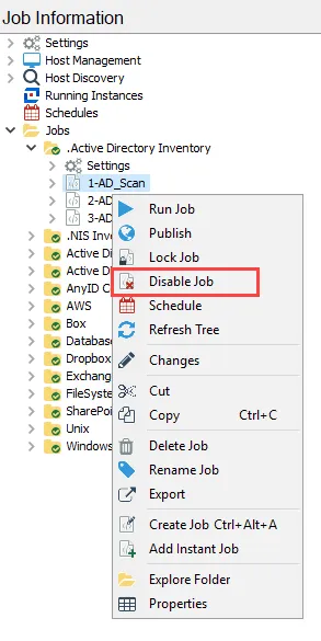

Step 1 – Select a job group or job.
When disabling jobs at the job group level, all jobs contained in the job group are disabled, but the job group isn't disabled. Any additional jobs added to that job group at a later time will be enabled by default.
Disable Job from Jobs Tree
Step 2 – Right-click the job group or job and select Disable Jobs from the menu.

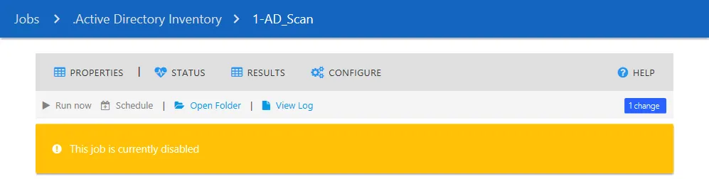

Disabled Job Description page banner
A yellow banner also notifies users that a job is disabled in the Job’s Description page.
Additionally, if a disabled job is run, a warning message appears in the Messages table stating: [UserName] requested [JobName] to run but it is in a disabled state. Job statistics also don't display on the job’s description page.

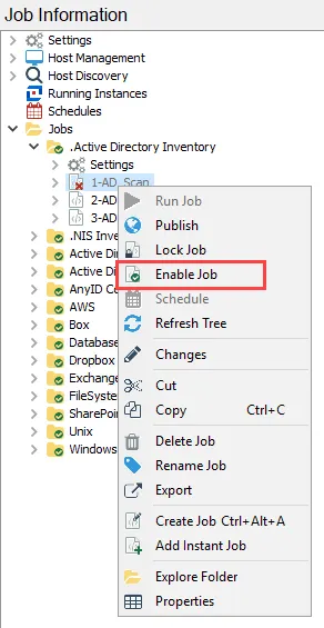

Step 1 – Select the disabled job. If multiple jobs in a job group are disabled, select the job group to enable all of the disabled jobs.
Enable Job from Jobs Tree
Step 2 – Right-click the job group or job and select Enable Jobs from the menu.
The job is now enabled. If a job group was selected, all the jobs in the group are now enabled.
