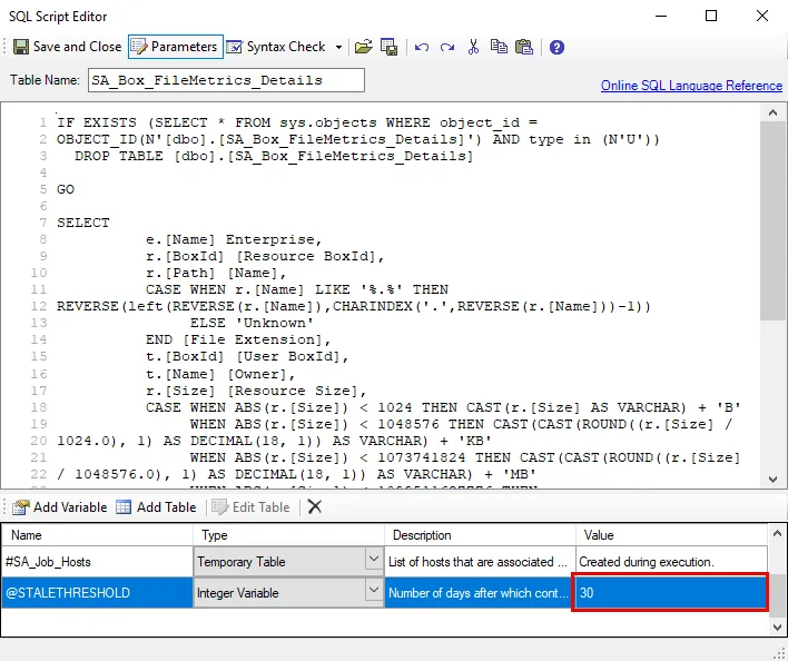

The parameters that can be customized and are listed in a section at the bottom of the SQL Script Editor. To customize an analysis task’s parameters:
Step 1 – Navigate to the Job’s Configure node and select Analysis.
Step 2 – In the Analysis Selection view, select the analysis task you want and click Analysis Configuration. The SQL Script Editor opens.
Step 3 – At the top of the SQL Script Editor, select Parameters.
The image shown is a generic example. Table names and customizable parameters will change based on the Job.
SQL Script Editor
Step 4 – In the parameters section at the bottom of the editor, find the Value column.
Don't change any parameters where the Value states Created during execution.
  • Double-click the customizable value and change as desired
Step 5 – Click Save and Close to finalize the customization and close the SQL Script Editor.
Repeat the steps as needed to customize analysis parameters.
