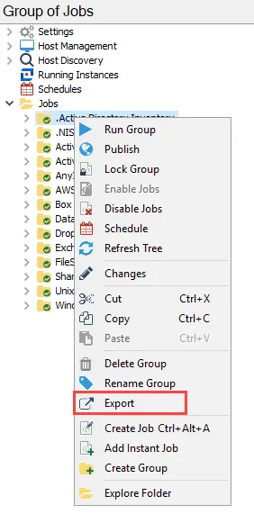

The Export Job to Zip Archive window opens from the Export option in the right-click menu from the selected job group or job node.
Export from Jobs Tree menu
Select Export from the right-click menu to open the Export Group to Zip Archive window.

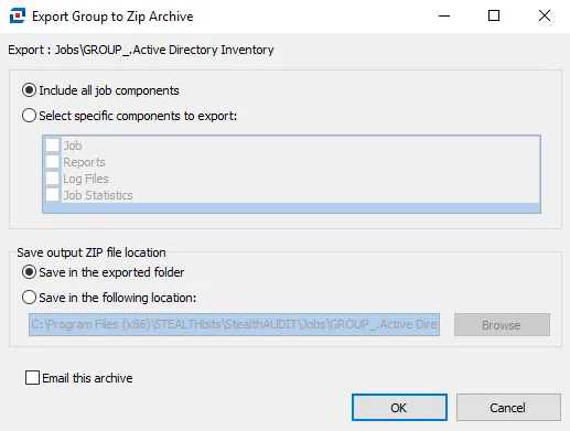

The Include all job components option will zip the job’s directory, the reports, the job log, and the SA_Debug log. The Select specific components to export option allows Access Analyzer users to select which components to include in the ZIP file.
There are two options for where to save the ZIP file:
  • Save in the exported folder – Saves the file in the job’s directory, for example %sainstalldir%Jobs\GROUP_.Active Directory Inventory\.Active Directory Inventory.zip
  • Save in the following location – Type or browse to the save location you want
The Email this archive checkbox lets you send an email notification with the attached ZIP file.

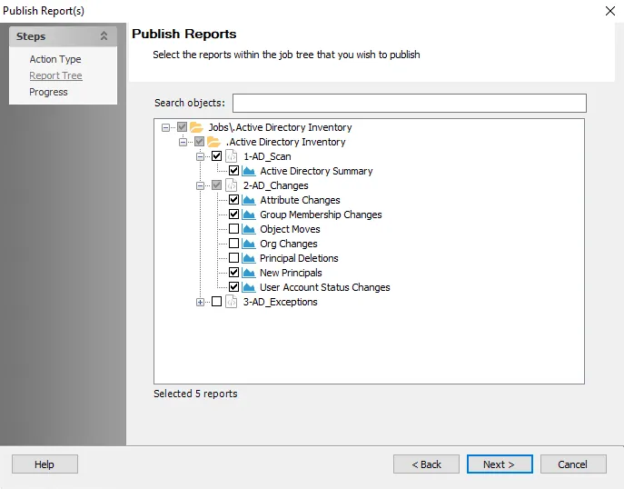

Publish Reports wizard Report Tree page
Step 3 – On the Report Tree page, select the reports to publish or remove (depending on the Action Type you selected in the previous step). Click Next to proceed with the action.
Step 4 – The Progress page shows you the status of the action. When it has completed, click Finish to exit the wizard.
You can view published reports under the [Job] > Results node or through the Web Console. See the Reporting topic for additional information.
