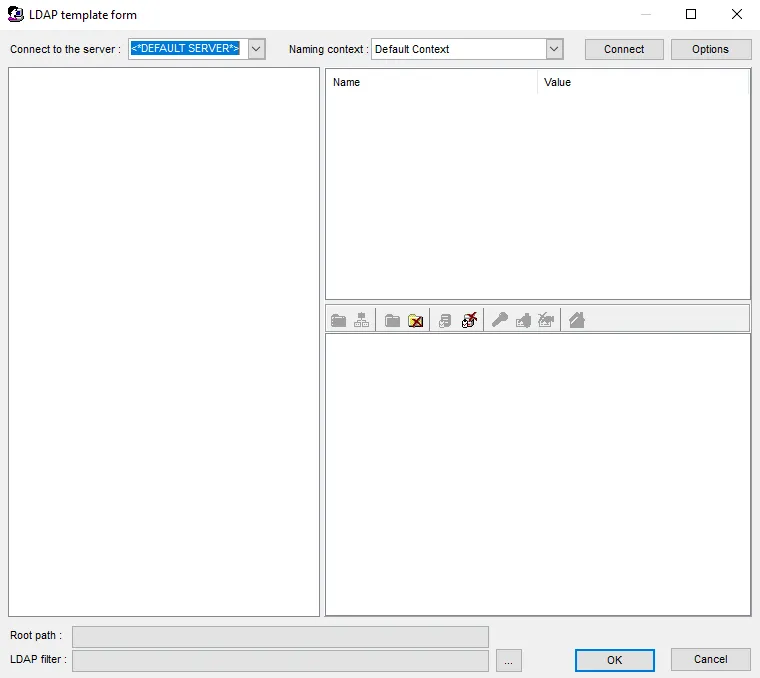

The LDAP Data Collector is configured through the LDAP template form. The LDAP template form has the following configuration options:
LDAP template form
  • Connect to the server – Use the default domain controller entered in the box, or enter an alternate server
  • Naming context – Select a directory partition from the dropdown list: Default Context, Configuration Context, or Schema Context
  • Connect – Connects to the domain specified. The root folder of the domain is displayed in the left pane of the window.
    Before clicking Connect, the server port must be configured. To configure the server port, click Options to open the Options window and configure the server port as described in the Options Window section.
  • Options – Opens the Options window to configure connection options and multi-value results options. See the Options Window topic for additional information.
  • List of attributes – Table in the upper right corner lists attributes for the object selected in the left pane
  • Root path – The Root path textbox is populated with the path to the highlighted attributes to be collected
  • LDAP filter – The LDAP filter textbox shows the filters applied to the objects. Click the ellipses () to open the Filter Options window. See the Filter Options Window topic for additional information.
The button bar provides additional options for selecting objects and attributes. See the Button Bar topic for additional information.
