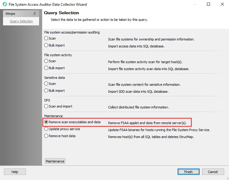

To build a new query using the FSAA Data Collector with the Remove scan executables and data category:
Step 1 – Navigate to the Configure node of a new or chosen job and select the Queries node.
Step 2 – In the Query Selection view, click the Create Query link. The Query Properties window displays.
Step 3 – Select the Data Source tab. From the Data Collector dropdown menu, select FILESYSTEMACCESS and then click the Configure button. The File System Access Auditor Data Collector Wizard opens.
FSAA Data Collector Wizard Query Selection page with Remove scan executables and data option selected
Step 4 – On the Query Selection page, select the Remove scan executables and data category.
Step 5 – Click Finish to save the selection and close the wizard. Then click OK to close the Query Properties window.
You've now configured this job to run the FSAA Data Collector and remove the file system access audit scan applet and data from the target server. Run the job to clean-up the targeted hosts.

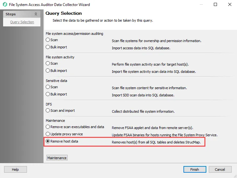

To build a new query using the FSAA Data Collector with the Remove host data category:
Step 3 – Select the Data Source tab. From the Data Collector dropdown menu, select FILESYSTEMACCESS and then click Configure. The File System Access Auditor Data Collector Wizard opens.
FSAA Data Collector Wizard Query Selection page with Remove host data option selected
Step 4 – On the Query Selection page, select the Remove host data category.
You've now configured this job to run the FSAA Data Collector and remove the host identified in the job’s Configure > Hosts node. Run the job to clean-up the targeted hosts.

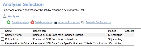

The FS_SDD_DELETE job removes host and criteria sensitive data matches from the Tier 1 database. It is preconfigured to run analysis tasks with temporary tables that requires modification before job execution. It is available through the Instant Job Library under the File System library. See the Instant Job Wizard topic for additional information.
FS_SDD_DELETE Job in Job's Tree
Run the 0.Collection Job Group before executing the FS_SDD_DELETE Job.
Analysis Tasks for the FS_SDD_DELETE Job
The analysis tasks are deselected by default. View the analysis tasks by navigating to the Jobs > FS_SDD_DELETE > Configure node and select Analysis.
Applying these analysis tasks deletes collected data.
FS_SDD_DELETE Job Analysis Selection page
  • Delete Criteria – Remove all SDD Data for a Specified Criteria
  • Delete Host – Remove all SDD Data Related to a Host
  • Remove Host & Criteria – Remove all SDD Data for a Specific Host and Criteria Combination

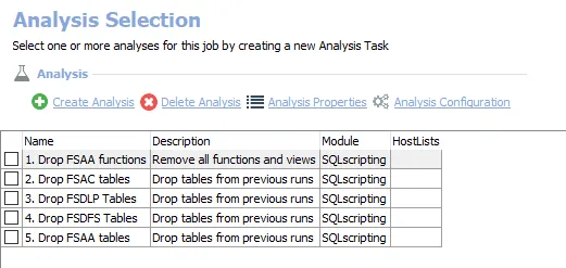

If it becomes necessary to clear the FSAA Data Collector tables and views to resolve an issue, the FS_DropTables Job is preconfigured to run analysis tasks that drop functions and views for the File System Solution as well as the standard tables and views generated by the FSAA Data Collector.
It is available through the Instant Job Library under the File System library. Since this job does not require a host to target, select Local host on the Hosts page of the Instant Job Wizard. See the Instant Job Wizard topic for additional information.
FS_DropTables Job in Job's Tree
The 0.Collection Job Group must be run before executing the FS_DropTables Job.
Analysis Tasks for the FS_DropTables Job
The analysis tasks are deselected by default. View the analysis tasks by navigating to the Jobs > FS_DropTables > Configure node and select Analysis.
FS_DropTables Job Analysis Selection page
  • 1. Drop FSAA functions – Removes all functions and views from previous runs of the File System Solution
  • 2. Drop FSAC tables – Drops the File System Activity Auditing tables imported from the previous runs
  • 3. Drop FSDLP Tables – Drops the File System Sensitive Data Discovery Auditing tables imported from the previous runs
  • 4. Drop FSDFS Tables – Drops the File System DFS Auditing tables imported from the previous runs
  • 5. Drop FSAA Tables – Drops File System Access Auditing tables imported from the previous runs
