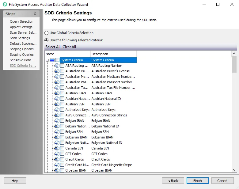

Use the SDD Criteria Settings page to configure criteria for discovering sensitive data during a scan. It is a wizard page for the category of Sensitive Data Scan.
FSAA Data Collector Wizard SDD Criteria Settings page
The options on the SDD Criteria Settings page are:
  • Use Global Criterion Selection – Select this option to inherit sensitive data criteria settings from the SettingsSensitive Data node. See the Sensitive Data topic for additional information.
  • Use the following selected criteria – Select this option to use the table to select which sensitive data criteria to scan for
  • Select All - Click Select All to enable all sensitive data criteria for scanning
  • Clear All - Click Clear All to remove all selections from the table
  • Select the checkboxes next to the sensitive data criteria options to enable them to be scanned for during job execution
The table contains the following types of criteria:
  • System Criteria – Lists pre-defined criteria
  • User Criteria – Lists user-defined criteria
    Use the Sensitive Data Criteria Editor in the SettingsSensitive Data to create and edit user-defined criteria. See the Sensitive Data Criteria Editor topic for additional information.
