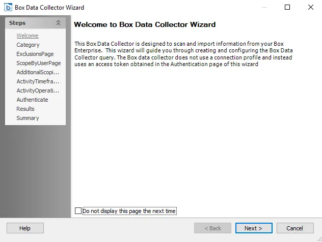

Configure the Box Data Collector through the Box Data Collector Wizard. The wizard contains the following pages, which change based on the query category selected:
- Welcome
- Box: Category
- Box: Exclusions Page
- Box: Scope by User Page
- Box: Additional Scoping
- Box: Activity Timeframe Scope
- Box: Activity Operation Scope
- Box: Authenticate
- Box: Results
- Box: Summary
The Welcome page gives an overview of the data collector. To proceed through the pages, click Next or use the Steps navigation pane to open another page in the wizard. Review the introductory and caution information about the Box Data Collector before proceeding.
To hide the Welcome page, check the Don't display this page the next time box while the wizard is open. This saves your configuration settings.
