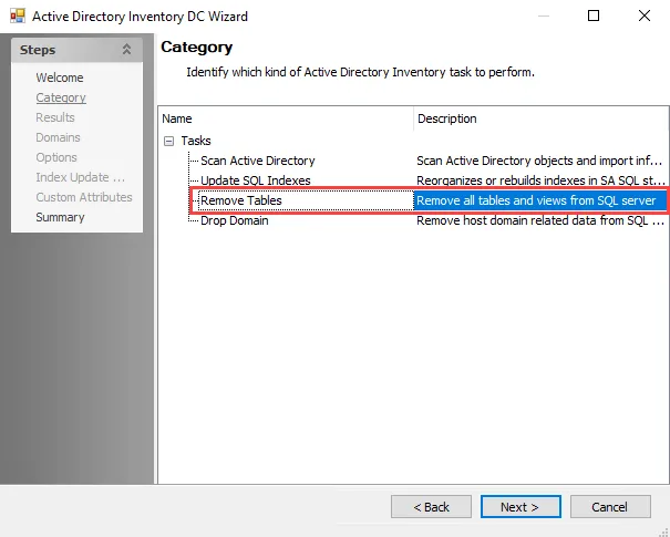

Step 1 – Create a new job and assign a query using the ADInventory Data Collector.
Remove Tables task selected on Active Directory Inventory DC Wizard Category page
Step 2 – In the Active Directory Inventory DC Wizard on the Category page, select the Remove Tables category task.
Step 3 – Click Next and then Finish to close the Active Directory Inventory DC Wizard. Click OK to close the Query Properties window.
When you run the job, it removes all ADInventory standard reference tables from the database.
Never leave the query task selected after job execution. Accidental data loss can occur.
