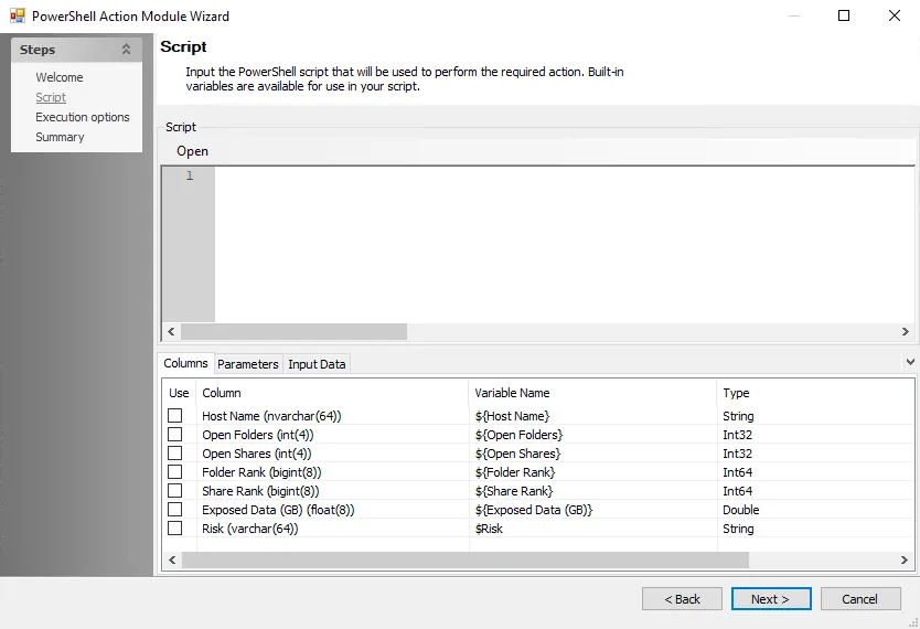

PowerShell Action: Script
Use the Script page to input the PowerShell script used to perform the requested action. Built-in variables are available for use in the script.
PowerShell Action Module Wizard Script page
You can enter the PowerShell script manually into the Script window at the top of the Script page. To open a pre-existing PowerShell script from a file, click Open to select the script file.
At the bottom of the page are three tabs to configure the PowerShell action module further. The tabs are:

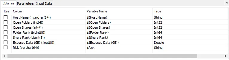

Columns
Use the Columns tab to select the available columns.
Columns tab
The table in the Columns tab displays the columns available for the PowerShell script. To use a column, select the checkbox under the Use column.

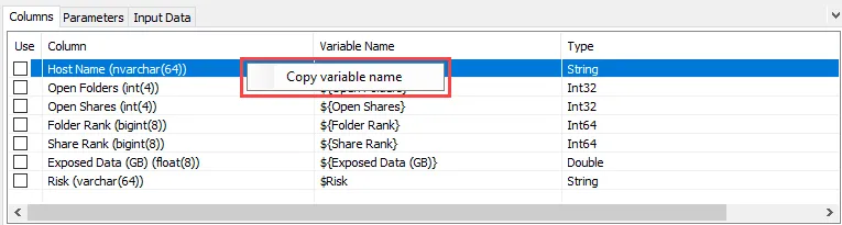

Right-click menu
Right-clicking any of the variable names brings up a Copy variable name option that enables users to paste the variable name into the PowerShell script.

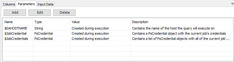

Parameters
The Parameters tab contains options to add, edit, or delete user-made PowerShell parameters.
Parameters tab
The options are:
  • Add – Clicking Add opens the Add/Edit Variable window. See the Add/Edit Variable Window topic for additional information.
  • Edit – Select an existing parameter and click Edit to open the Add/Edit Variable window. See the Add/Edit Variable Window topic for additional information.
    • Double-clicking an existing parameter also opens the Add/Edit Variable window
  • Delete – Delete a selected parameter
You can't edit or delete the built-in default parameters.
