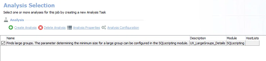

Navigate to the Unix > 1.Users and Groups > UX_LargeGroups > Configure node and select Analysis to view the analysis tasks.
Analysis Tasks for the UX_LargeGroups Job
The default analysis task is:
  • Finds large groups. The parameter determining the minimum size for a large group can be configured in the SQL scripting module. – Creates the UX_LargeGroups_Details table accessible under the job’s Results node
    • The threshold value used to determine if a group is considered large can be customized. See the Parameter Configuration for additional information.
