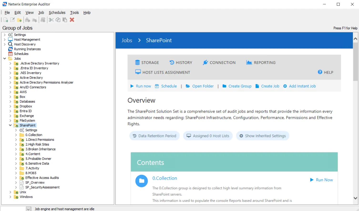

The SharePoint Solution requires a special Enterprise Auditor license. It can be installed from the Enterprise Auditor Instant Job Wizard. After it has been installed into the Jobs tree, navigate to the solution: Jobs > SharePoint.
The 0.Collection Job Group collects the data. The other job groups and the SP_Overview Job run analysis on the collected data and generate reports.

This SharePoint solution offers information on multiple aspects of an organization’s SharePoint on-premises and SharePoint Online environments. This solution is comprised of 10 sub-job groups and an overview job which collect, analyze, and report on data. The data collection is conducted by the SharePointAccess (SPAA) Data Collector. See the corresponding Standard Reference Tables & Views for the SPAA Data Collector topic for database table information.
