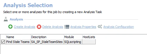

Navigate to the Jobs > SharePoint > 8.M365 > SP_StaleTeamSites > Configure node and select Analysis to view the analysis tasks.
The default analysis task is:
Find Stale Teams – Creates the SA_SP_StaleTeamSites table accessible under the job’s Results node
- This task contains a configurable parameter to set the number of days a Team has not had activity for before it's considered stale. See the Customizable Analysis Tasks for the SP_StaleTeamSites Job topic for additional information.
