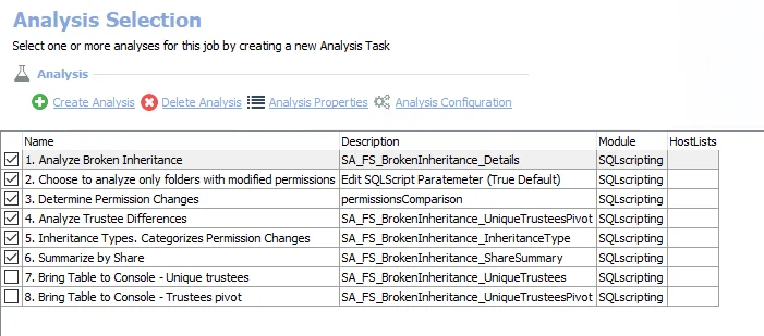

Analysis Tasks for the FS_BrokenInheritance Job
View the analysis tasks by navigating to the FileSystem > 3.Broken Inheritance > FS_BrokenInheritance > Configure node and select Analysis.
Most of these analysis tasks are preconfigured and shouldn't be modified and/or deselected. There are some that are deselected by default, as they are for troubleshooting purposes.
  • 1. Analyze Broken Inheritance
    • Creates an interim processing table in the database for use by downstream analysis and report generation
    • Creates the SA_FS_BrokenInheritance_UniqueTrustees table accessible under the job's Results node
    • Creates the SA_FS_BrokenInheritance_UniqueTrusteesPivot table accessible under the job's Results node
  • 2. Choose to analyze only folders with modified permissions – Creates an interim processing table in the database for use by downstream analysis and report generation
    • By default set to only analyze resources with changed permissions from parent
    • Can be modified to analyze all resources regardless of permission changes between parent and child. See the Parameter Configuration topic for additional information.
    • Alternatively, you can set this by modifying the @FILTER_TO_CHANGED_RESOURCES parameter. See the Configure the Customizable Parameters in an Analysis Task topic for additional information.
  • 3. Determine Permission Changes – Creates an interim processing table in the database for use by downstream analysis and report generation
  • 4. Analyze Trustee Differences – Creates an interim processing table in the database for use by downstream analysis and report generation
  • 5. Inheritance Types. Categorizes Permission Changes – Creates an interim processing table in the database for use by downstream analysis and report generation
  • 6. Summarize by Share – Creates an interim processing table in the database for use by downstream analysis and report generation
The following analysis tasks are deselected by default:
  • 7. Bring Table to Console - Unique trustees – Restores the SA_FS_BrokenInheritance_UniqueTrustees table to be visible under the job's Results node
  • 8. Bring Table to Console - Trustees pivot – Restores the SA_FS_BrokenInheritance_UniqueTrusteesPivot table to be visible under the job's Results node
