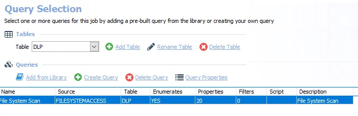

Step 1 – Navigate to the FileSystem > 0.Collection > 1-SEEK System Scans > Configure node and select the Queries node.
Step 2 – In the Query Selection view, click Query Properties. The Query Properties window opens.

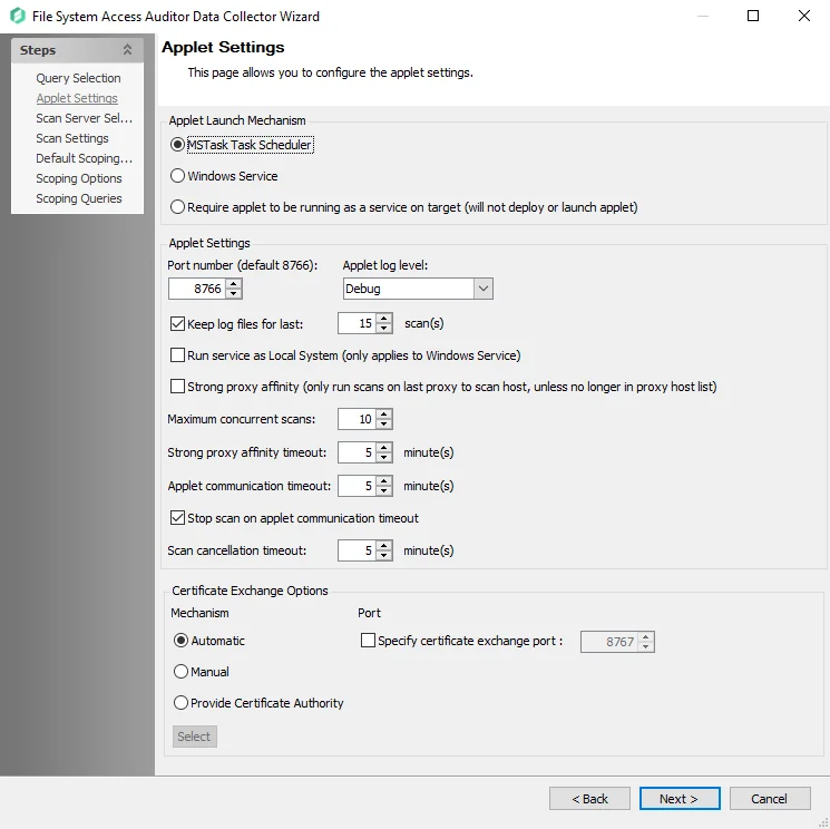

Applet Settings
Step 4 – The Applet Settings page applies to the applet and proxy mode scans which you select on the Scan Server Selection page. If employing proxy servers, see the FSAA: Applet Settings topic for configuration instructions.

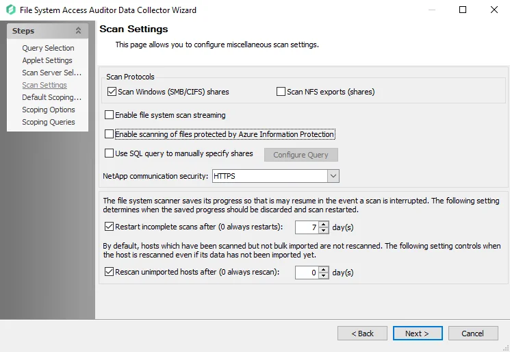

Scan Settings
Step 6 – On the Scan Settings page, you can enable streaming. See the FSAA: Scan Settings topic for additional information.
If you enable streaming, you no longer need the 2-SEEK Bulk Import job as part of the 0.Collection job group.

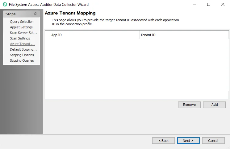

Azure Tenant Mapping
Step 7 – On the Azure Tenant Mapping page, enable Azure Information Protection (AIP). See the FSAA: Azure Tenant Mapping topic for additional information.

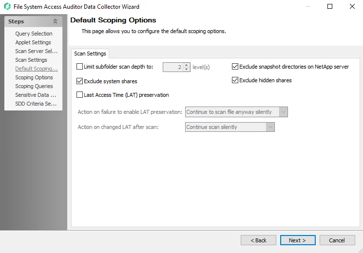

Default Scoping Options
Step 8 – On the Default Scoping Options page, configure the following on the Scan Settings tab:
  • Limit subfolder scan depth to – Select this checkbox and use the arrow buttons to modify the subfolder scan depth
  • Exclude snapshot directories on NetApp server – Select this checkbox to exclude snapshot directories on NetApp server
  • Exclude system shares – Select this checkbox to exclude system shares
  • Exclude hidden shares - Select this checkbox to exclude hidden shares
  • Last Access Time (LAT) preservation – Select this checkbox to specify action on Last Access Time (LAT) preservation as follows:
    • Action on failure to enable LAT Preservation – Before scanning each file, FSAA attempts to enable an operating system feature to preserve the LAT when accessing the file. This operation may fail for a variety of reasons, including: the operating system or file system where the file is located doesn't support LAT preservation, or insufficient permissions from the service account trying to access the file. The following configuration addresses a failure to enable the LAT preservation mode:
      • Continue to scan file silently – FSAA scans the file even if LAT preservation isn't possible. No warning appears.
      • Continue to scan file with warning – FSAA scans the file even if LAT isn't preserved. A warning appears for this file.
      • Skip file silently – FSAA will not scan the file. No warning appears.
      • Skip file with warning – FSAA will not scan the file. A warning appears indicating the file was skipped.
      • Abort the scan – FSAA will abort the scan. No further files will be processed.
    • Action on changed LAT After scan – Before scanning each file, the LAT of the current file is recorded. After scanning, FSAA verifies whether the LAT has changed since then (likely scenarios are either that the LAT preservation mechanism failed to function as intended, or that the file was accessed by someone while the scan was occurring). The following configuration addresses a changed LAT:
      • Continue scan silently – The scan will move on to the next file while updating the LAT for the processed file. No warning appears.
      • Continue scan with warning – The scan will continue on to the next file. LAT will be updated for the processed file. A warning appears.
      • Force-reset file LAT silently – The scan will reset the file's LAT to its original state before processing. No warning appears. The scan will proceed to the next file.
      • Force-reset file LAT with warning – The scan will reset the file's LAT to its original state before processing. A warning appears. The scan will proceed to the next file.
      • Abort the scan – FSAA will abort the scan. LAT will be updated for the processed file. No other files will be processed
See the Scan Settings Tab topic for additional information.

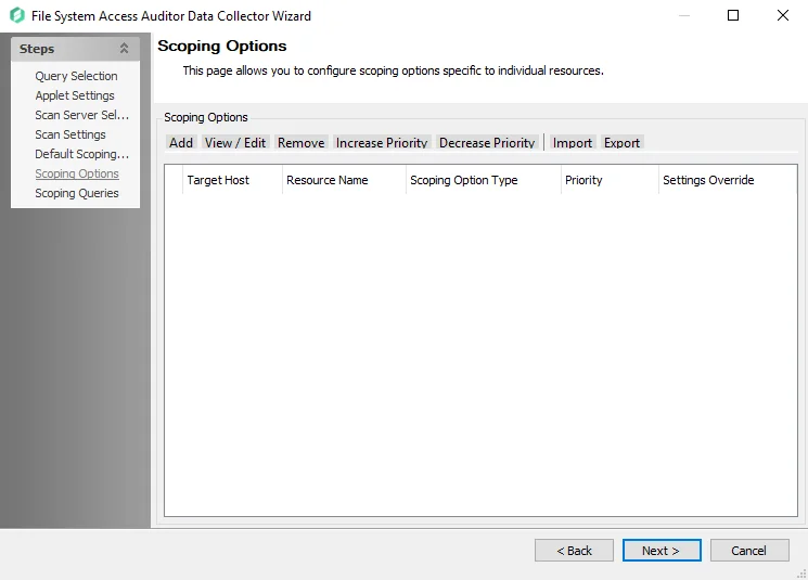

Scoping Options
Step 9 – On the Scoping Options page, add share/folder inclusions and exclusions. See the FSAA: Scoping Options topic for additional information:

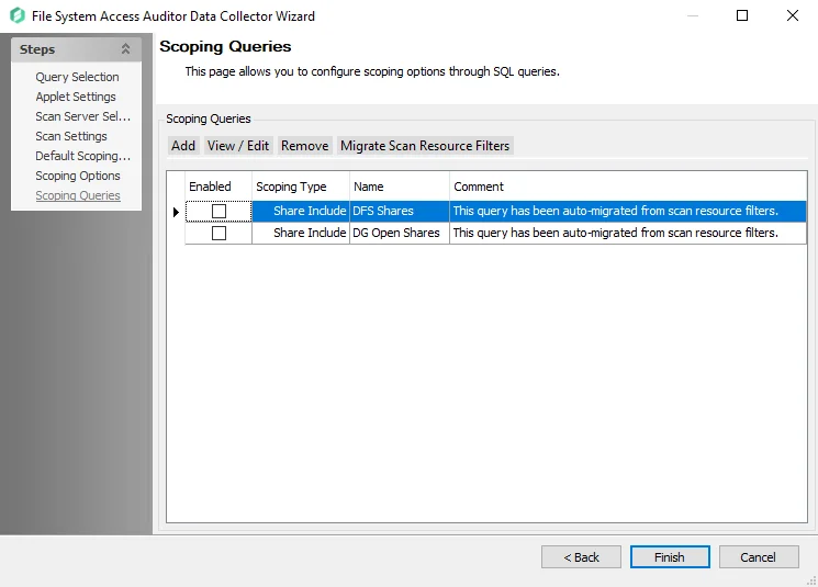

Step 10 – On the Scoping Queries page:
  • Add share and folder inclusions
  • Add share and folder exclusions
  • Scope to scan only Open shares
This option only works with File System Access Auditing.
See the FSAA: Scoping Queries topic for additional information.

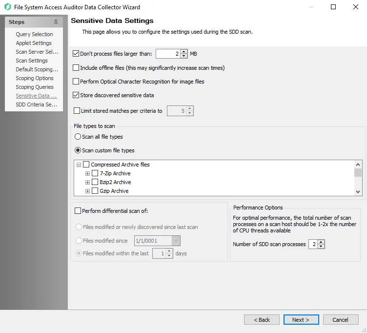

Sensitive Data Settings
Step 11 – On the Sensitive Data Settings page:
  • Modify maximum file size to be scanned
  • Add scanning offline files
  • Modify file types to be scanned
  • Enable differential scanning
  • Modify the number of SDD scan processes
    info
    For optimal performance, the total number of scan processes on a scan host should be 1 to 2 times the number of CPU threads available.
  • Enable Optical Character Recognition (OCR) scans
    The OCR option is intended to work for clear scanned physical documents or documents directly converted to images, with standard fonts. It will not work for scanning photos of documents and may not be able to recognize text on images of credit cards, driver's licenses, or other identity cards.
See the FSAA: Sensitive Data Settings topic for additional information.

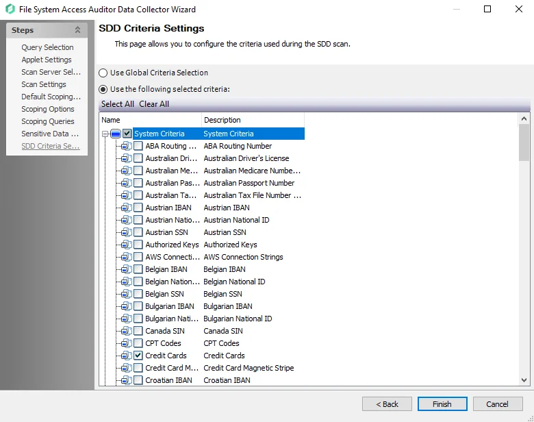

SDD Criteria Settings
Step 12 – Add or remove criteria on the SDD Criteria Settings page as desired. See the FSAA: SDD Criteria Settings topic for additional information.
By default, discovered sensitive data strings aren't stored in the Enterprise Auditor database.
