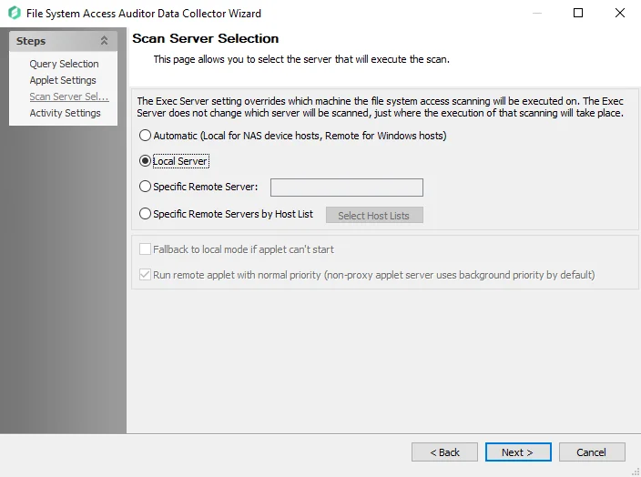

  • Scan Server Selection page:
    • Set to Local Server, or local mode scans

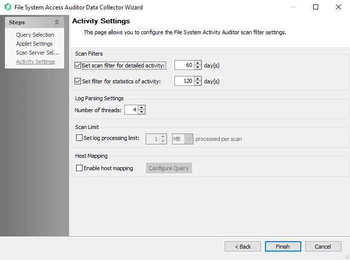

  • Activity Settings page:
    • Set scan filter for detailed activity 60 days
    • Set filter for statistics of activity 120 days

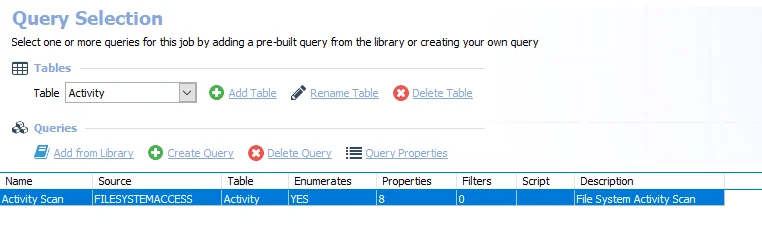

Configure the Activity Scan Query
The 1-FSAC System Scans job has been preconfigured to run with the default settings with the category of File system activity Scan. To customize the configuration, complete the following steps.
Step 1 – Navigate to the FileSystem > 0.Collection > 1-FSAC System Scans > Configure node and select the Queries node.
Step 2 – In the Query Selection view, click Query Properties. The Query Properties window opens.

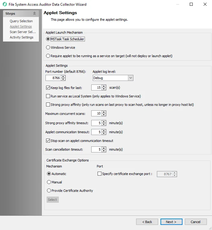

Applet Settings
Step 4 – The Applet Settings page applies to the applet and proxy mode scans which you select on the Scan Server Selection page. If employing proxy servers, see the FSAA: Applet Settings topic for configuration instructions.
Step 5 – The Scan Server Selection page applies to the applet and proxy mode scans. Remember, each mode has different provisioning requirements. See the FSAA: Scan Server Selection topic for additional information.
Activity Settings
Step 6 – On the Activity Settings page:
  • Modify the number of days detailed activity is kept
  • Modify the number of days activity statistics are kept
  • Modify log parsing limits
See the FSAA: Activity Settings topic for additional information.
Step 7 – Click Finish to save any setting modifications or click Cancel if you made no changes. Then click OK to close the Query Properties window.
