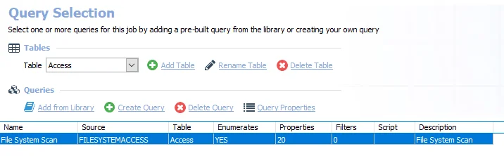

Step 1 – Navigate to the FileSystem > 0.Collection > 1-FSAA System Scans > Configure node and select the Queries node.
Step 2 – In the Query Selection view, click Query Properties. The Query Properties window opens.

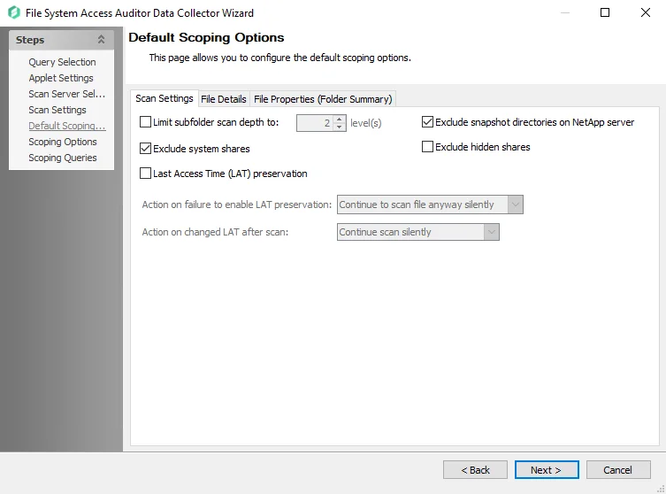

Step 8 – On the Default Scoping Options page, configure the following on the Scan Settings tab:
  • Limit subfolder scan depth to – Select this checkbox and use the arrow buttons to modify the subfolder scan depth
  • Exclude snapshot directories on NetApp server – Select this checkbox to exclude snapshot directories on NetApp server
  • Exclude system shares – Select this checkbox to exclude system shares
  • Exclude hidden shares – Select this checkbox to exclude hidden shares
  • Specify action on Last Access Time (LAT) preservation as follows:
    • Action on failure to enable LAT Preservation – Before scanning each file, FSAA attempts to enable an operating system feature to preserve the LAT when accessing the file. This operation may fail for a variety of reasons, including: the operating system or file system where the file is located doesn't support LAT preservation, or insufficient permissions from the service account trying to access the file. The following configuration addresses a failure to enable the LAT preservation mode:
      • Continue to scan file silently – FSAA scans the file even if LAT preservation isn't possible. No warning appears.
      • Continue to scan file with warning – FSAA scans the file even if LAT isn't preserved. A warning appears for this file.
      • Skip file silently – FSAA will not scan the file. No warning appears.
      • Skip file with warning – FSAA will not scan the file. A warning appears indicating the file was skipped.
      • Abort the scan – FSAA will abort the scan. No further files will be processed.
    • Action on changed LAT After scan – Before scanning each file, the LAT of the current file is recorded. After scanning, FSAA verifies whether the LAT has changed since then (likely scenarios are either that the LAT preservation mechanism failed to function as intended, or that the file was accessed by someone while the scan was occurring). The following configuration addresses a changed LAT:
      • Continue scan silently – The scan will move on to the next file while updating the LAT for the processed file. No warning appears.
      • Continue scan with warning – The scan will continue on to the next file. LAT will be updated for the processed file. A warning appears.
      • Force-reset file LAT silently – The scan will reset the file's LAT to its original state before processing. No warning appears. The scan will proceed to the next file.
      • Force-reset file LAT with warning – The scan will reset the file's LAT to its original state before processing. A warning appears. The scan will proceed to the next file.
      • Abort the scan – FSAA will abort the scan. LAT will be updated for the processed file. No other files will be processed
See the Scan Settings Tab topic for additional information.

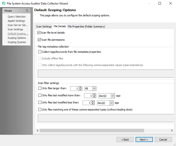

File Details tab of the Default Scoping Options page
Step 9 – On the File Details tab of the Default Scoping Options page, you can enable file-level scans. See the File Details Tab topic for additional information.
info
Carefully consider configuring the following settings. Applying filters after you enable file detail scanning reduces the impact on the database.

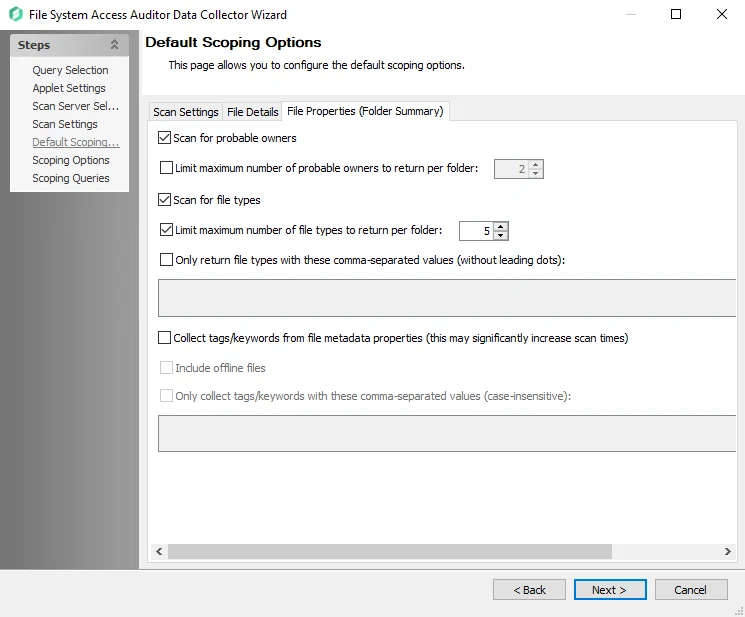

File Properties (Folder Summary) tab of the Default Scoping Options page
Step 10 – On the File Properties (Folder Summary) tab of the Default Scoping Options page, you can configure the following:
  • Enable scan for probable owners
  • Add a limit to the number of probable owners returned
  • Scope file types to scan
  • Add collection of tags and keyword
  • Enable return of files with only comma-separated values (CSV files).
See the File Properties (Folder Summary) Tab topic for additional information.

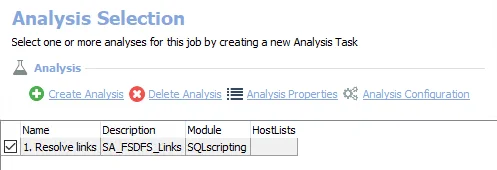

Analysis Task for the 1-FSAA System Scans Job
View the analysis task by navigating to the FileSystem > 0.Collection > 1-FSAA System Scans > Configure node and selecting Analysis.
  • 1. Resolve links – Resolves DFS links in standard tables
