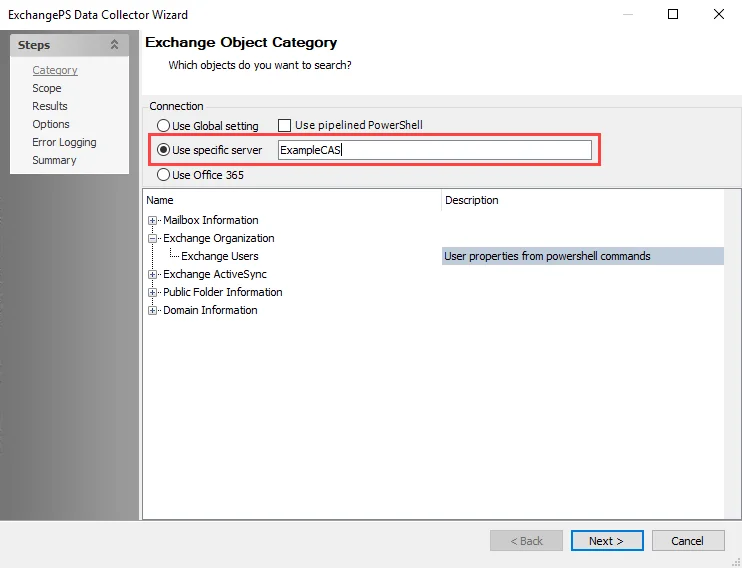

To supply a CAS name for data collection:
Step 1 – Navigate to the job’s Configure node and select Queries.
Step 2 – In the Query Selection view, click Query Properties. The Query Properties window opens.
Step 3 – Select the Data Source tab, and click Configure. The ExchangePS Data Collector Wizard opens.
Unless otherwise indicated within the job group section, don't make changes to other wizard pages as they have been pre-configured to support the job.
Step 4 – On the Category page, select the Use specific server option and enter the CAS name in the text box. See the ExchangePS: Category topic for additional information.
Step 5 – Navigate to the Summary page. Click Finish.
The job now successfully targets Exchange 2013 and 2016 environments.
