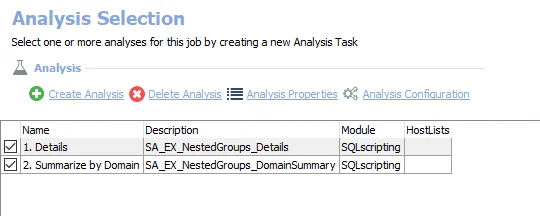

Analysis Tasks for the EX_NestedGroups Job
View the analysis tasks by navigating to the Exchange > 6. Distribution Lists > Membership Analysis > EX_NestedGroups > Configure node and select Analysis.
  • 1. Details – Creates the SA_EX_NestedGroups_Details table, accessible under the job’s Results node
  • 2. Summarize by Domain – Creates the SA_EX_NestedGroups_DomainSummary table, accessible under the job’s Results node
