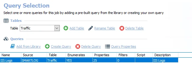

The following query is included in the EX_IISLogs Job:
  • IIS Logs – Collects IIS Logs
    • By default set to process log files for the last 3 days. This time frame can be modified
    • See the Configure the IIS Logs Query topic for additional information

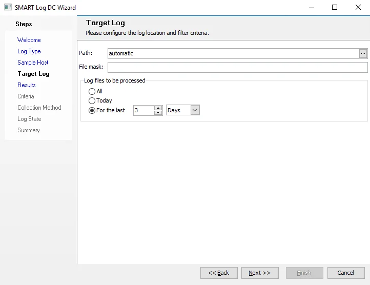

The EX_IISLogs Job has been preconfigured to run with the default settings with the Log Type of Internet Information Server Log. However, the time frame for the log files to be processed can be modified on the Target Log page of the SMART Log DC Wizard. See the SMARTLog Data Collector topic for additional information.

Step 1 – Navigate to the Exchange > 2. CAS Metrics > 0. Collection > EX_IISLogs > Configure node and select Queries.
Step 2 – In the Query Selection view, click Query Properties. The Query Properties window opens.
Step 3 – Select the Data Source tab, and click Configure. The SMART Log DC Wizard opens.
Don't modify other wizard pages. The other wizard pages are pre-configured for this job.
SMART Log DC Wizard Target Log page
Step 4 – Navigate to the Target Log page, and configure the time frame as required. See the SMARTLog: Target Log topic for additional information.
