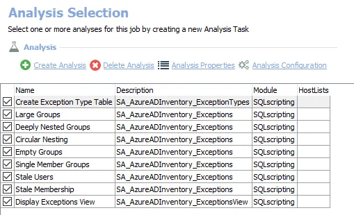

Analysis Tasks for the 2-AAD_Exceptions Job
Navigate to the .Entra ID Inventory > 2-AAD_Exceptions > Configure node and select Analysis. You can modify analysis tasks with configuration parameters that define security concerns.
Most of these analysis tasks are preconfigured. Don't modify or deselect them. A few are deselected by default because they're for troubleshooting.
Analysis Tasks for 2-AAD_Exceptions Job
  • Create Exception Type Table – Creates a processing table in the database for use by downstream analysis and report generation
  • Large Groups
    • Identifies groups that exceed the defined threshold for effective group membership
    • Populates processing tables in the database for use by downstream analysis and report generation
    • This analysis task has configurable parameters
      • Definition of a larger group can be customized
  • Deeply Nested Groups
    • Identifies groups that exceed the defined threshold of deep levels of membership nesting
      • Definition of a deeply nested group can be customized
  • Circular Nesting
    • Identifies groups with circular references in their effective membership
  • Empty Groups
    • Identifies groups with no membership
  • Single Member Groups
    • Identifies groups with a single direct member
  • Stale Users
    • Identifies user accounts that are disabled or exceed the defined threshold of inactivity
      • Definition of a stale user can be customized
  • Stale Membership
    • Identifies groups with a high percentage of effective members that are stale users
      • Definition of a stale membership can be customized
  • Display Exceptions View – Creates the SA_AzureADInventory_ExceptionsView accessible under the job’s Results node

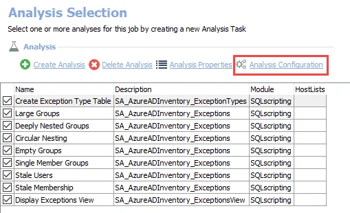

Step 1 – Navigate to the .Entra ID Inventory > 2-AAD_Exceptions > Configure node and select Analysis.
Analysis Configuration option on Analysis Selection page
Step 2 – In the Analysis Selection view, select an analysis task and click Analysis Configuration. The SQL Script Editor opens.

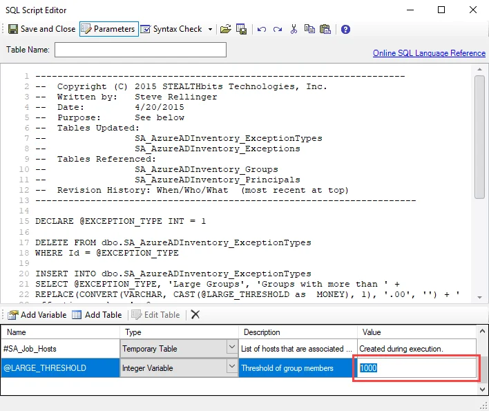

Step 3 – Click Parameters to open the Parameters section.
Change Parameter Value in SQL Script Editor
Step 4 – Double-click in a field in the Value column and enter a custom value.
Don't change any parameters where the Value states Created during execution.
Step 5 – Click Save and Close to finalize the customization and close the SQL Script Editor.
